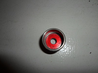

Millions of 870s with steel followers still out there and working fine.
Re: Follower issues?
Yeah, there's nothing innately wrong with metal followers. Remington themselves used stamped metal followers for decades until polymers improved to the point where they would serve reliably. Most stainless steel alloys are fairly soft, and shouldn't cause any major wear as they slide inside the tube. They certainly wouldn't be any harder on the gun than the steel rims on modern shotshells.
Galling is really only an issue with high-friction stainless-on-stainless contact, such as using a tight-fitting stainless machine screw in a threaded stainless hole without any lubricant. With certain alloys, this can scrape off the protective chromium oxide layers, and the two surfaces try to bond together. Even if 870 mag tubes were made of a soft stainless (which they aren't), there's very little force pushing the follower against the interior of the tube.
That said, I do prefer quality polymer followers over metal ones. The Delrin S&J followers are excellent, and I would recommend them to anyone.

That's great now I have a 25.00+ follower that is a paper weight. Well maybe I can sell it in a garage sale. I have been using the green follower that came with the Wilson Combat mag tube kit. I like it and so far it works great. Thanks for all the info, also I will keep working on the picture resolution size, not liking this resize program its funky and won't resize them all the time or at all it seems.

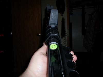

Here is the green poly follower that came with the Wilson combat 2+ mag tube extension kit and this one works great
GG&G stainless steel follower that I have had issues with. This one would not allow me to feed all 6 shells into the mag tube.
