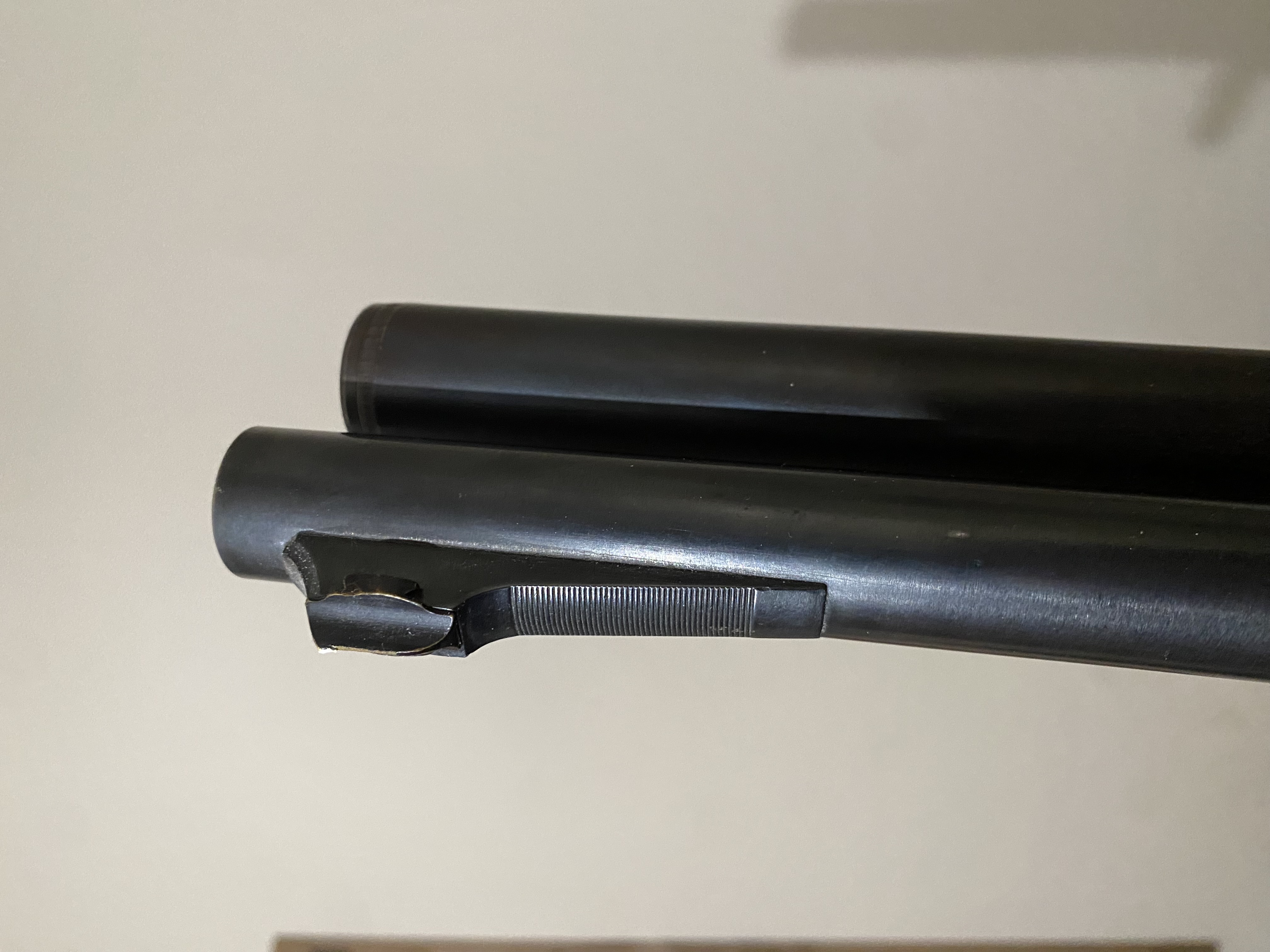

Does anyone know what dovetail sight could be used to replace this one on an old Wingmaster 20” rifle sighted 12 gauge? Top snapped off. The rear sight style is pictured too in case that matters or helps.

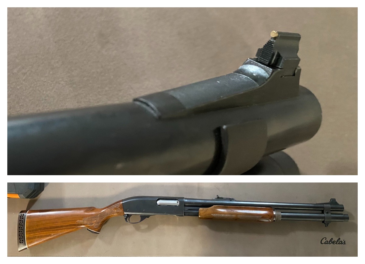

Rear sight pic

One more try

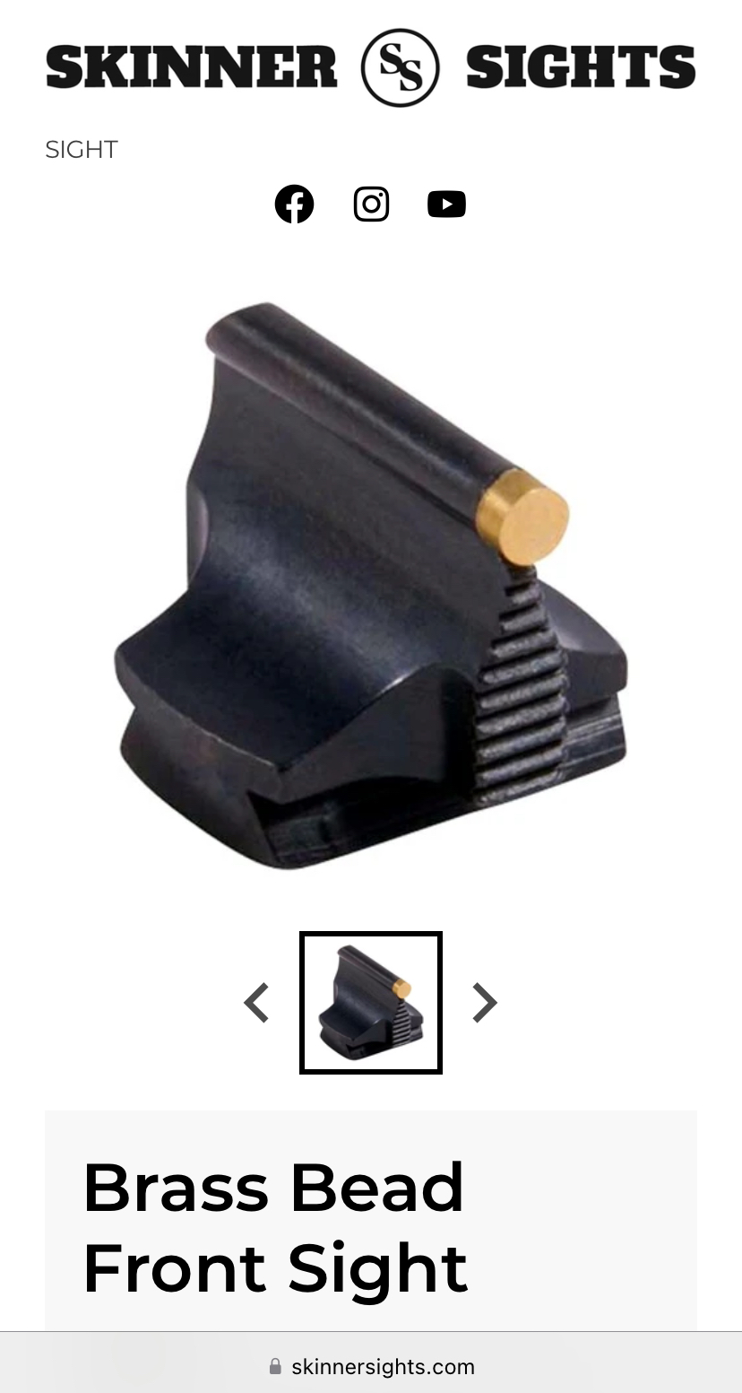

Ordered one of these. Had to guess on height. Fingers crossed.

Took a little bit of file fitting as expected. I think it’s a touch taller than the original but I have plenty of adjustment left in the rear and that will help me extend my zero out to 100 yards anyway. The “bead” is noticeably smaller, so that will help with slug groups too. Over all, as always, very pleased with skinner sights.

Choose the correct height to match your rear sight (typically 0.360" to 0.500" or more).

Interesting question. Identifying the correct replacement sight usually comes down to measuring the dovetail and matching the sight height to the existing rear sight.
