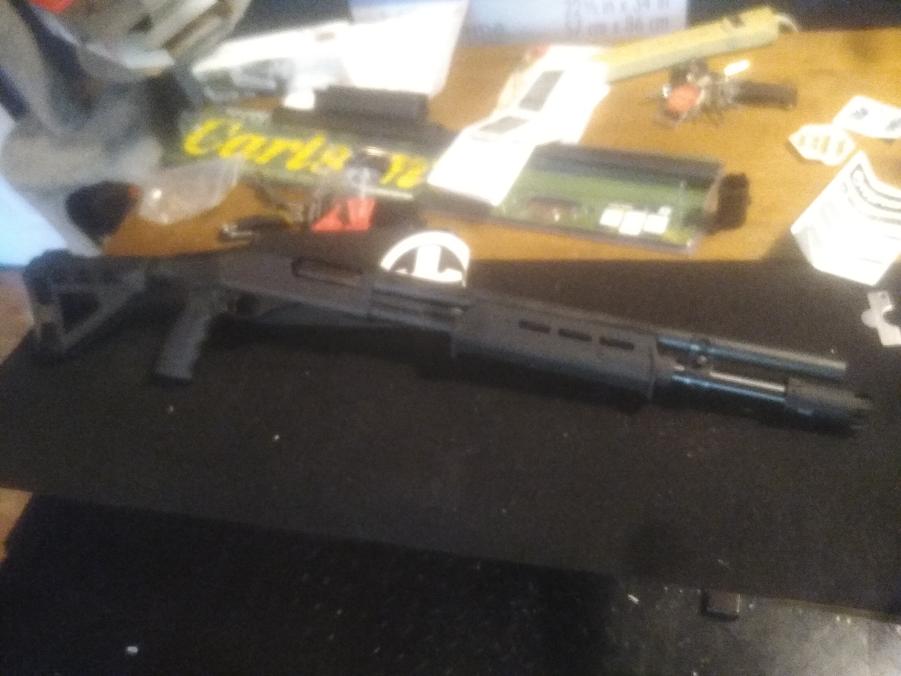

It worked on this super mag. No idea why it's considered not compatible

Same here. Have one on my 870 Super Mag. Seems fine.

I searched the internets high and low a while back looking for this info but I couldn't find it. So I decided to be the change I wanted to see in the world. Maybe this will help someone else someday.
It is possible to fit a Magpul MOE forend to a Remington 870 Express Super Magnum with some minor fitting. You need to remove a small amount of plastic from each side where the forend overlaps and snags on the end of the receiver. Other people have installed the forend backwards and avoided this problem while causing other minor issues such as looking like a dolt. The folks at Magpul could have easily made small modifications to their design to allow this to work out of the box.

In this case, too. I have an 870 Super Mag with one. Everything seems good.
