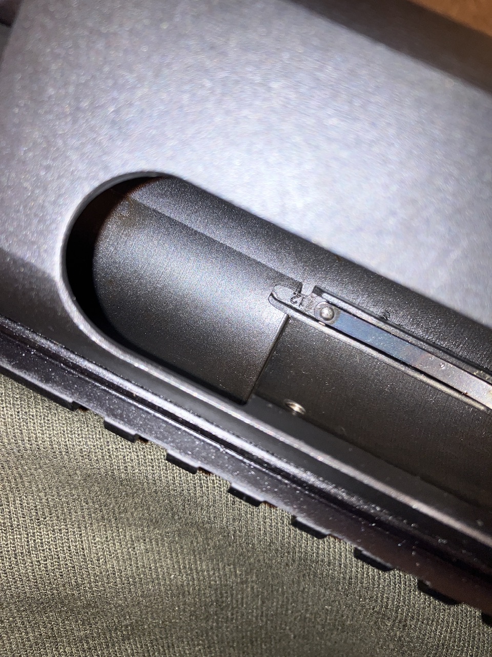

How’s this ejector looking. Its mim injected looks like crack or maybe where the injection was molded,. It donsnt go all the way through

If it's not affecting extraction I'd probably go with "If it ain't broke, don't fix it" solution.
If you decide to replace it, here is a blog post on how to do it.
https://www.rem870.com/2011/10/25/remington-870-ejector-spring-replacement/

Re: Ejector
Post by Boss870 »
Forward of rivet break looks terminal. Waiting for a breech disaster not a good option. Replacement is best done by a gunsmith with all the correct tools.. The special rivet drill hasn't been available for a long time. Tempering the bits steel wasn't done. Brownels didn't refund buyer. Read every thing you can. ?any contradictions on YouTube.
