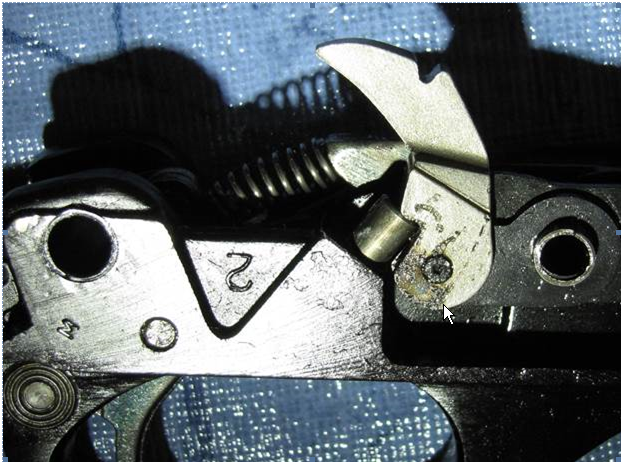

Picture of the carrier dog
Post by Scattered »
A brief summary: The never fired, never oiled 870 Wingmaster appears to be in perfect condition but when I tore it down I noticed that the carrier dog was pitted and discolored. I sprayed the gun with CLP and when I wiped it off I found a small amount of orange on the white cloth. Because of the pitting on the carrier dog and the orange on the cloth I assumed that bad things were happening (rust) so I drenched all metal parts with CLP and left the parts in that condition.
I sent a query to Remington about the orange and they've responded as follows:
"...If the firearm was new and never used or cleaned it would have a packing component that we use called cosmoline for rust prevention. When wiped off the firearm it looks like a reddish brown color some mistake for rust. If indeed it is rust and not cosmoline CLP is a good product to use to remove and protect from further damage...."
So I'm now hopeful that it's just cosmoline because other than the orange I see no evidence of rusting - unless the discoloration and pitting on the carrier dog is actually rusting.
Since by merely changing the barrel the 870 can either be a home defense weapon or used for hunting I'm going to be doing the flex-tab, non MIM extractor, etc. upgrades and buying a 2nd barrel. Also, if I replace the carrier assembly the carrier dog is automatically replaced too but that doesn't tell me if there are any other parts (such as springs) in the 37 year old trigger assembly that should be replaced too.
Synchronizer - If you think this project would make a good video I'd consider transporting to weapon to you. If not, then that's O.K. too.

Re: What parts should be replaced in a never fired 1978 12ga
That does kind of look like corrosion pitting at the bottom of the carrier dog. It could also conceivably be a manufacturing defect - someone at the factory didn't have the riveting jig lined up right, or something like that. Either way, as far as I can tell, the carrier dog still seems perfectly serviceable. As long as it moves freely about the carrier dog pin, cosmetic blemishes there shouldn't have any effect on function. Besides, as you pointed out, you're going to be replacing the carrier assembly anyway as part of the flex-tab update.
As for the rest of the trigger plate assembly, if the gun was never fired, all the springs and other wear parts should be just fine. If you're concerned, it certainly wouldn't hurt to have a gunsmith give it a quick looking-over, but barring corrosion or other environmental deterioration, the parts should be just as sound as they were back in 1978.
