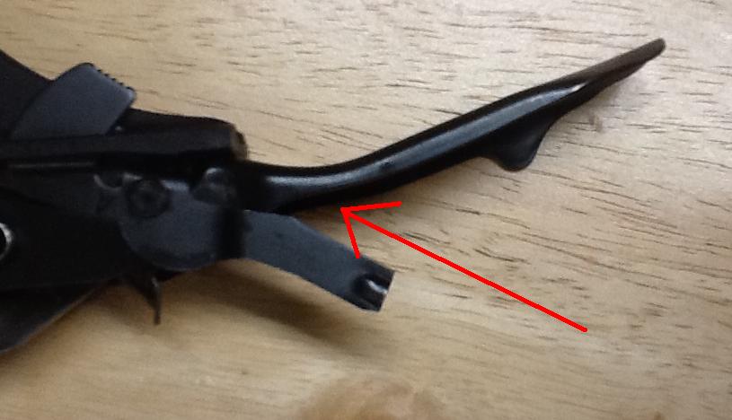

fwoom wrote:I can't for the life of me imagine how the carrier got messed up (if it is, indeed, the carrier). And comparing the assembly to my non-mag assembly, they look identical, except for the carrier itself protruding further. No identifiable buckles, or anything. Just weird.
It looks to me like your carrier bent near where it meets the trigger plate. The side flanges are shortest there, and could conceivably stretch that far without buckling or cracking.
bend ID.JPG (43.44 KiB) Viewed 5211 times
If I had to guess, I'd say the drop only slightly tweaked or jarred the carrier - just enough for the rear of your fore-end to slip underneath and bend it the rest of the way out to where it is now.
