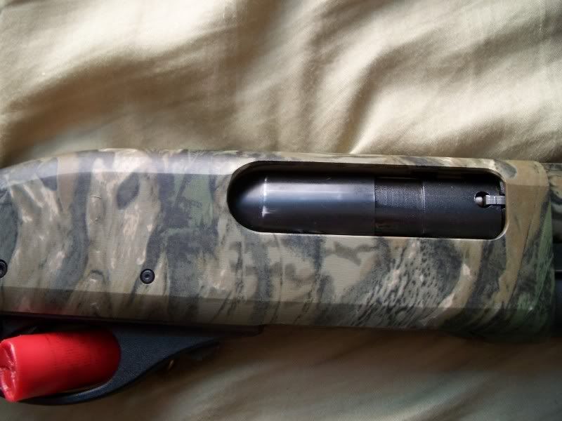

Now I am trying to get the old one back in working order. I have re-assembled it and it seems to work fine...but it appears there is something missing (see the photo) behind the bolt. There is a gap I dont remember in the past...lol.
I spoke with a local gunsmith and they said its safe to shoot.
Can anyone tell me what...if anything...is missing?

It doesn't look like anything is missing, but your port cover - the metal piece attached to the rear of your breech bolt - is jammed in the forward position. When the action is closed, the port cover should slide back under spring pressure and cover the rear portion of the enlarged super magnum ejection port.
Your port cover may be bent or misaligned, or perhaps its spring is damaged. The gun should be fully functional without the port cover if you end up having to order and wait for replacements, but obviously that opening will let debris or foreign matter fall right into the trigger plate assembly, so I'd stick to fair-weather hunting or range shooting until you get the cover fixed.
