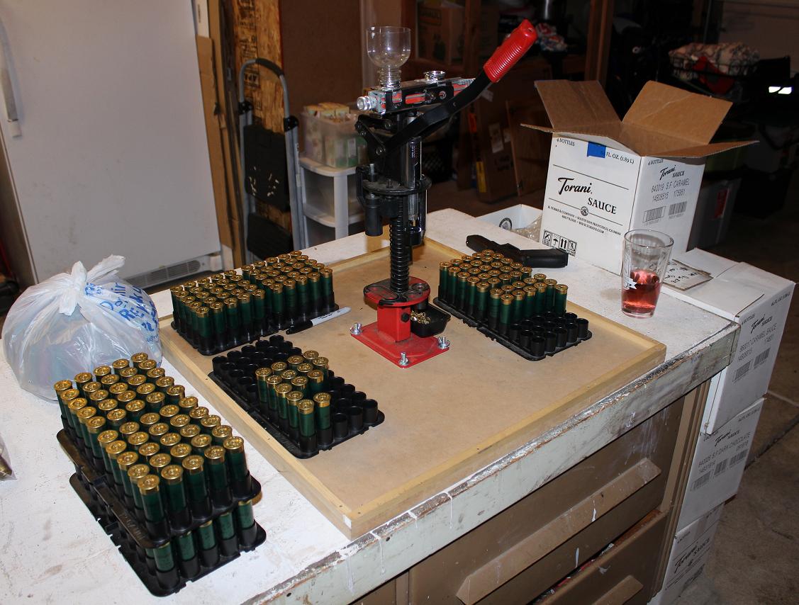

My setup is a MEC 600 Jr. MkV that I got off Craigslist for $100. That $100 also got me a second partially-complete press for parts, some shot, wads, primers, and powder (be wary of used energetic components, though), some load data booklets, and a few other useful odds & ends like a hull sectioning jig. I knocked together a cheap base for it, made sure everything was adjusted correctly, and I was ready to go.
I handload pretty much everything I shoot now, and it's awesome being able to produce exactly what I need. A lot of what I shoot isn't available in stores, too - like 3/4-ounce plinking loads, low-recoil slugs (which I cast myself), and ultra-cheap loads containing scrap shot for recoil testing.
