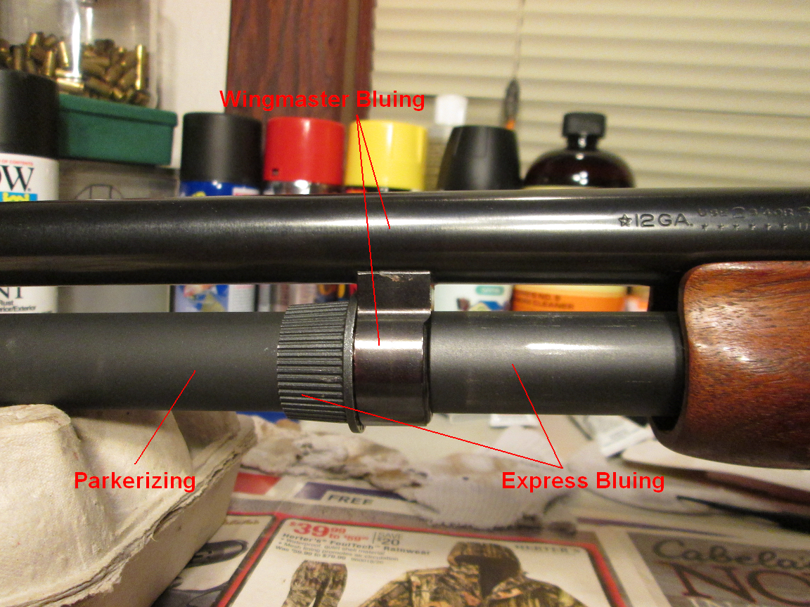

Actually, Remington parkerizing is essentially the same finish as what comes on the current 870's...like the matte black finish on the Express. Years ago the Remington OD green parkerizing was much closer to real parkerizing than what can be had today.
Re: Scored another used 870 today
They look similar, and both are conversion coatings, but they're completely different chemically. Bluing forms a layer of black iron oxide, while Parkerizing forms a layer of metal phosphate (different metals can be used, I'm not sure what Remington uses). I have both matte blued and Parkerized parts for my 870, and there's a slight, but noticeable difference in appearance between the two finishes.
