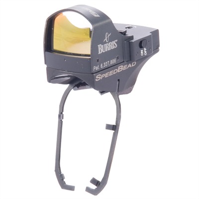

Burris Speedbead red dot rear sight
Phase 4 I installed a Burris Speedbead red dot rear sight and a Hi Vis snap on fiber optic front sight.
