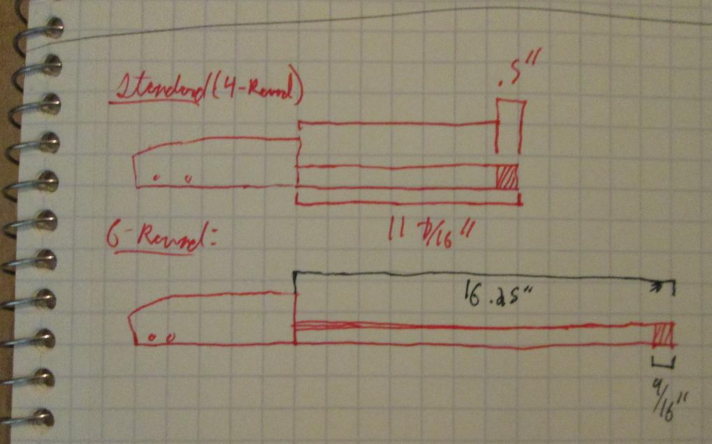

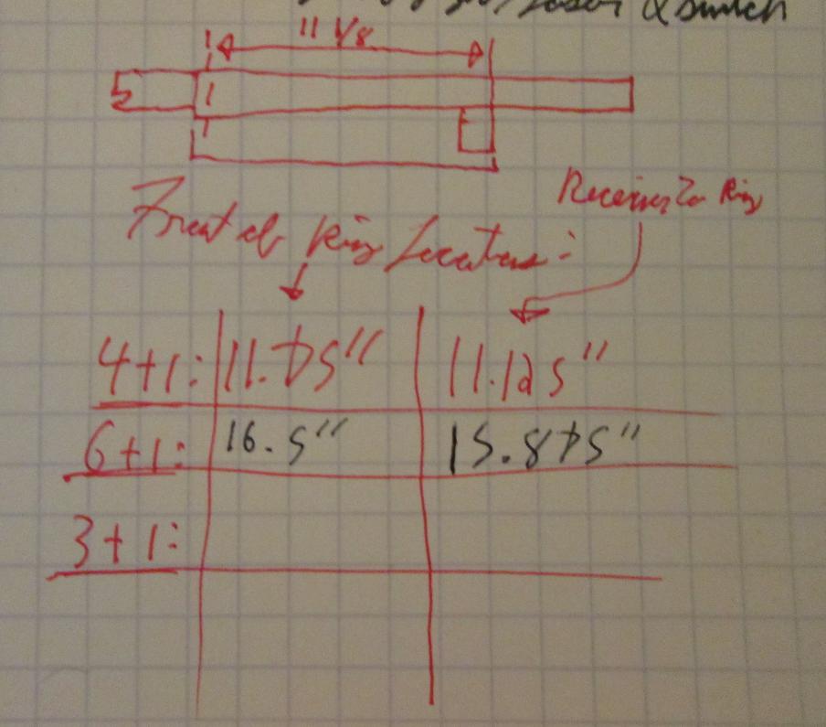

I am was curious about where the ring connects to the mag tube. I was wondering if they are at different lengths along the mag tube in 4+1 magazine tubes and 6+1 magazine tubes.

Look at this thread, give it a minute for the pictures to load, (synchronizers post); It clearly shows the difference between the two.

reeps wrote:I am was curious about where the ring connects to the mag tube. I was wondering if they are at different lengths along the mag tube in 4+1 magazine tubes and 6+1 magazine tubes.
Here are my notes on the subject:
870 rng notes 1.JPG (74.4 KiB) Viewed 4031 times
870 rng notes 2.JPG (68.66 KiB) Viewed 4031 times
Haven't yet come across a 3+1 870 MCS or Special Field that I could take apart and measure.
