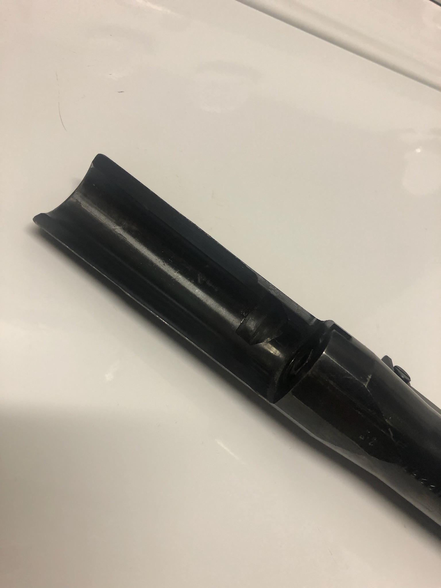

It should fit. Can you upload picks of the chamber end of the barrel and a pic of it not fitting in the receiver?

Even Hastings website has no info. Got any pics of the receiver-end?

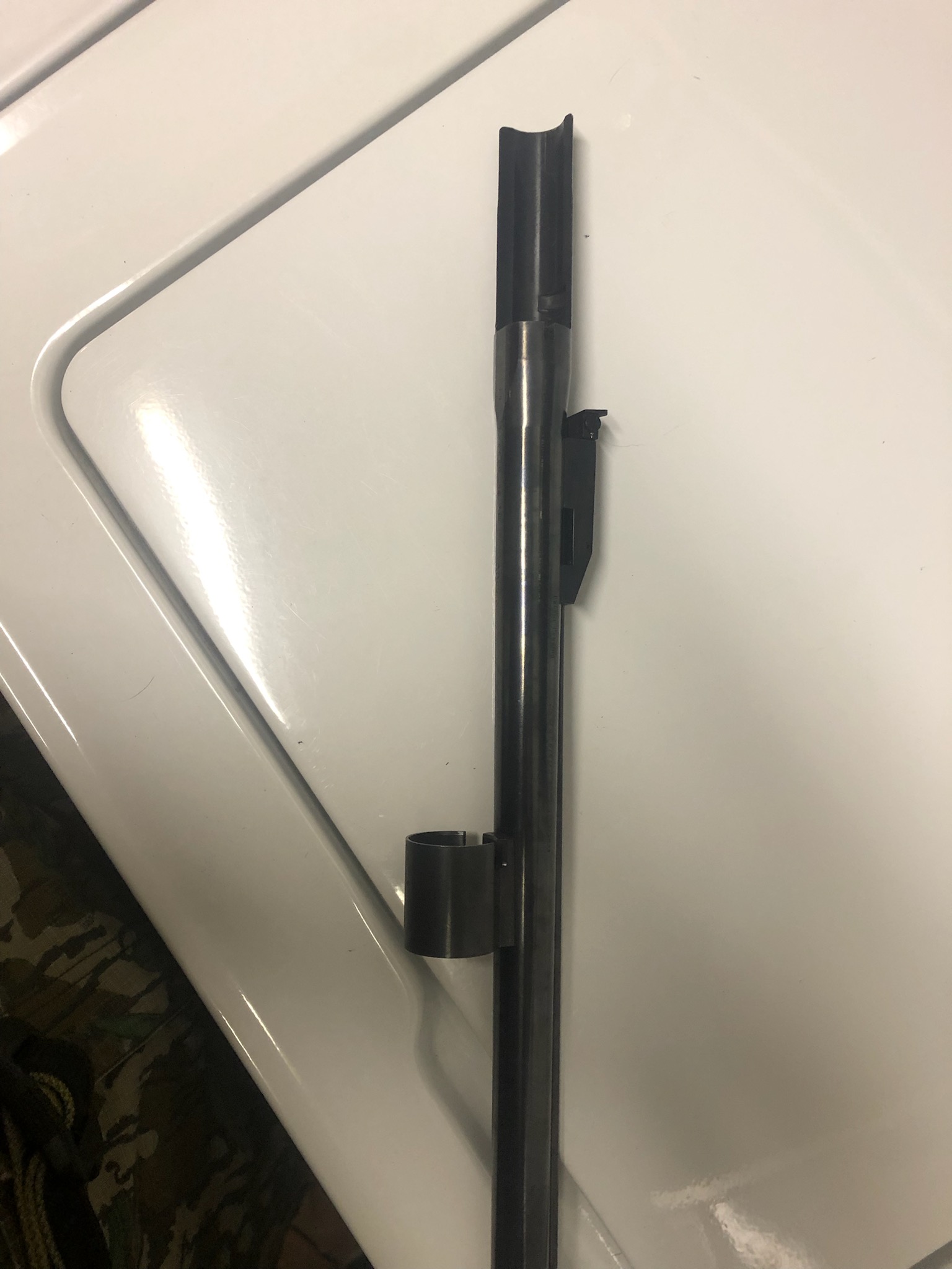

I have added two photos, but I think, after more careful inspection, I can also add some additional information. On the main part of the breach end, the barrel is marked Hastings Paradox, M-870, and it lists "black powder and Pyrodex." However, my grandson found that on the underside of the barrel, it is marked M1100. Our confusion is on how a semi-automatic can take a single shot black powder barrel. The very breach end of the barrel clearly has a place for a 209 primer.
I do appreciate the help from the more experienced Remington owners. I have three, all 870 express models, two standard and one tactical. It does not fit any of those. So one more question is could it fit and fire on an 1100? I did write the surviving corporation of Hastings. They are in France. No reply from them.

lostpine wrote: Sat Mar 26, 2022 11:30 am Our confusion is on how a semi-automatic can take a single shot black powder barrel.
They did make them for the 1100's according to the info. The shotgun would just function like a single-shot, but probably very dirty for the gas system.
