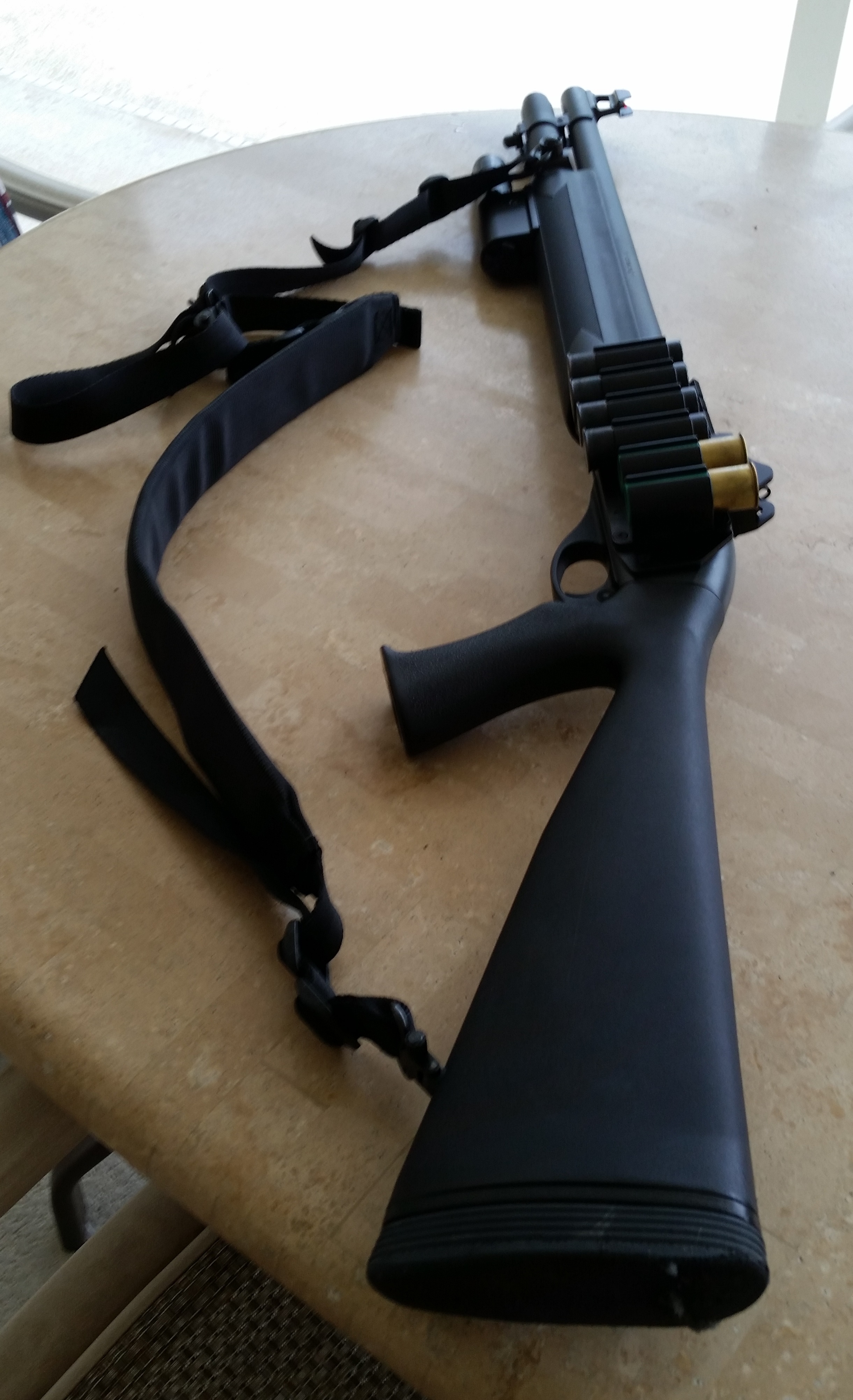

I was a machinist/tool maker for 8 years, so I know how to do it. I do wish I had a mill. Drilling is easy...tapping small holes is the scary part. :-) I think I'll go with a rail and the LPA. Basically the same rear sight at half the price. I DO want the barrel job from Vang though. Attached is my 1100 that I tapped. It was scary but I love the LPA sights. Surefire forend and remington mag on there as well. Never fails to go BANG when I tug the loud button. There is something about an 870 though, which explains me fiddling with a couple police trades!

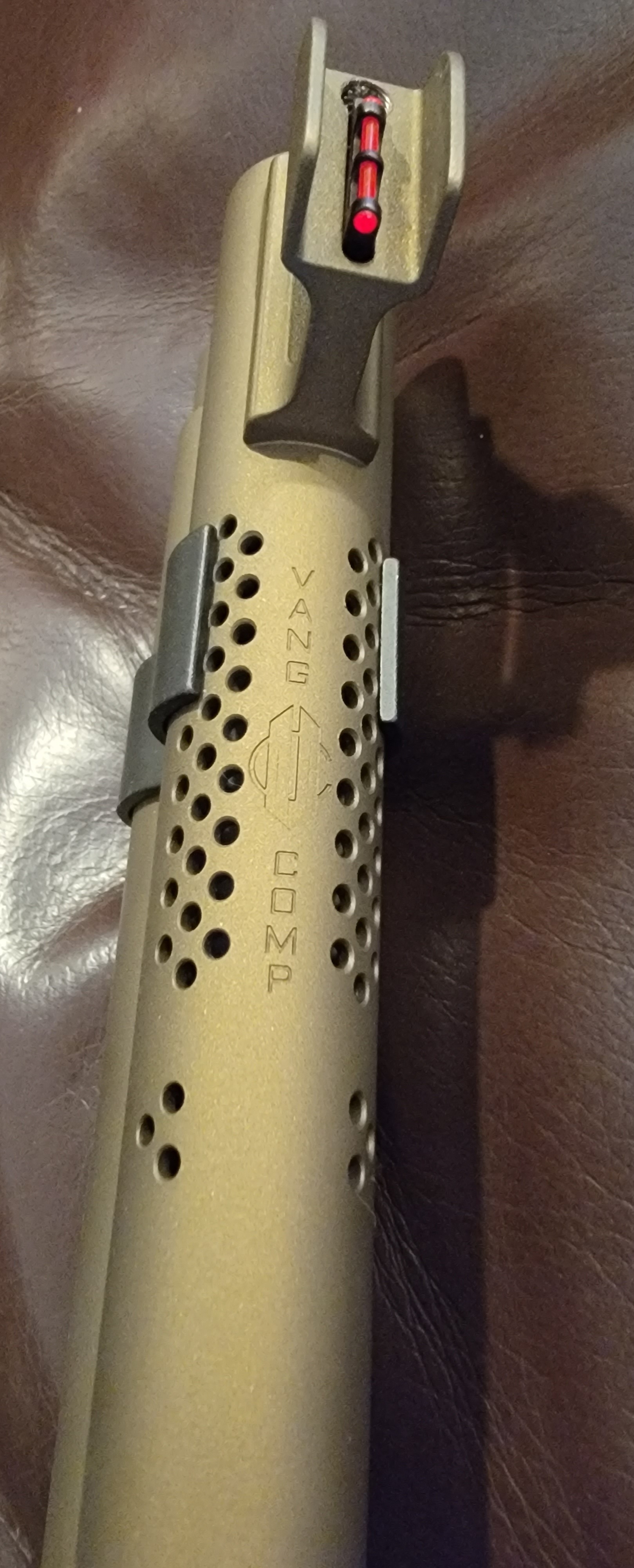

Fair enough! Ancient post and I thank you for your response. I've since learned a few things! So the Vang sight and rail are one piece. You can't take the sight off and slap on an optic. I think that's a bad design.

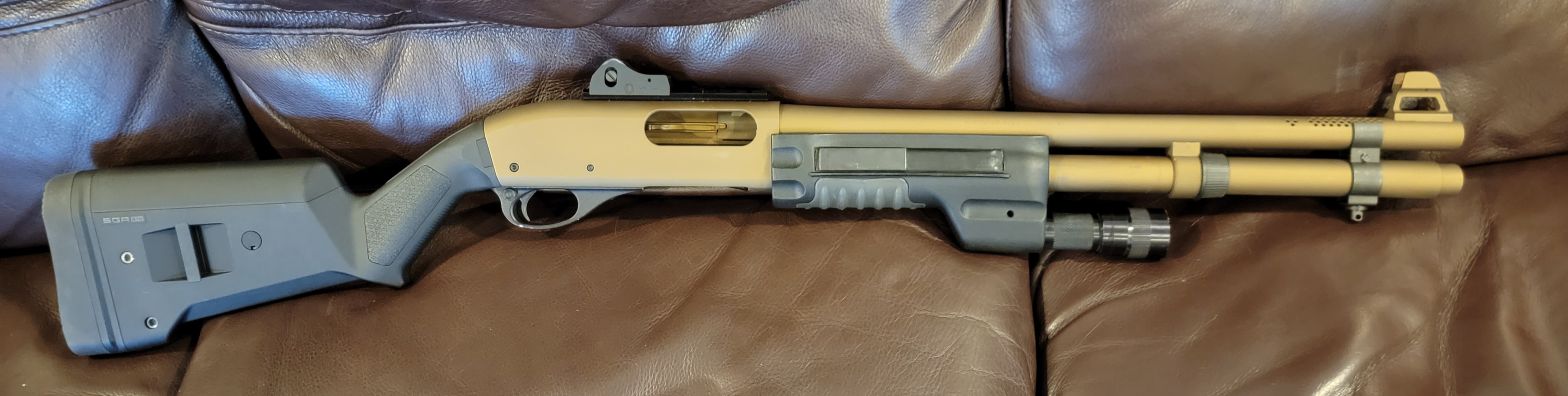

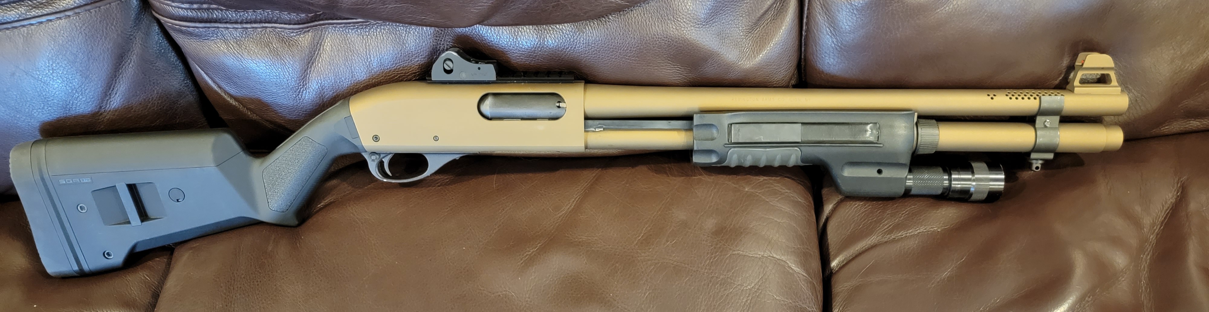

What I ended up doing was A) left my railed, LPA 1100 alone. Porting an auto-feeder is a bad idea and would probably never cycle again. I did get an 870P and sent that to Vang for the whole works. However, I had them add a side rail and solder the LPA front sight on. They did the port job, forcing cone and back boring. The shotty is amazing!
My only gripe is that it took over a year to get my 870P back. Also cost me as much as if I'd just bought a completed 870 from them.
Here's the end product:
PS- I sent the rail, and the LPA sights with my shotty
