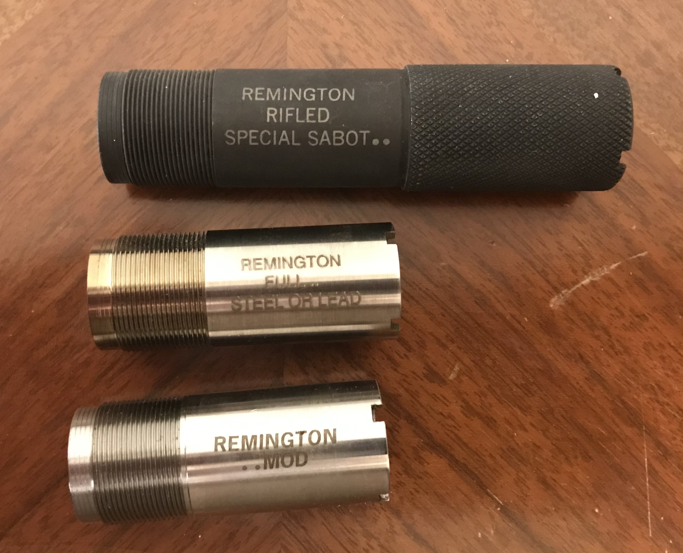

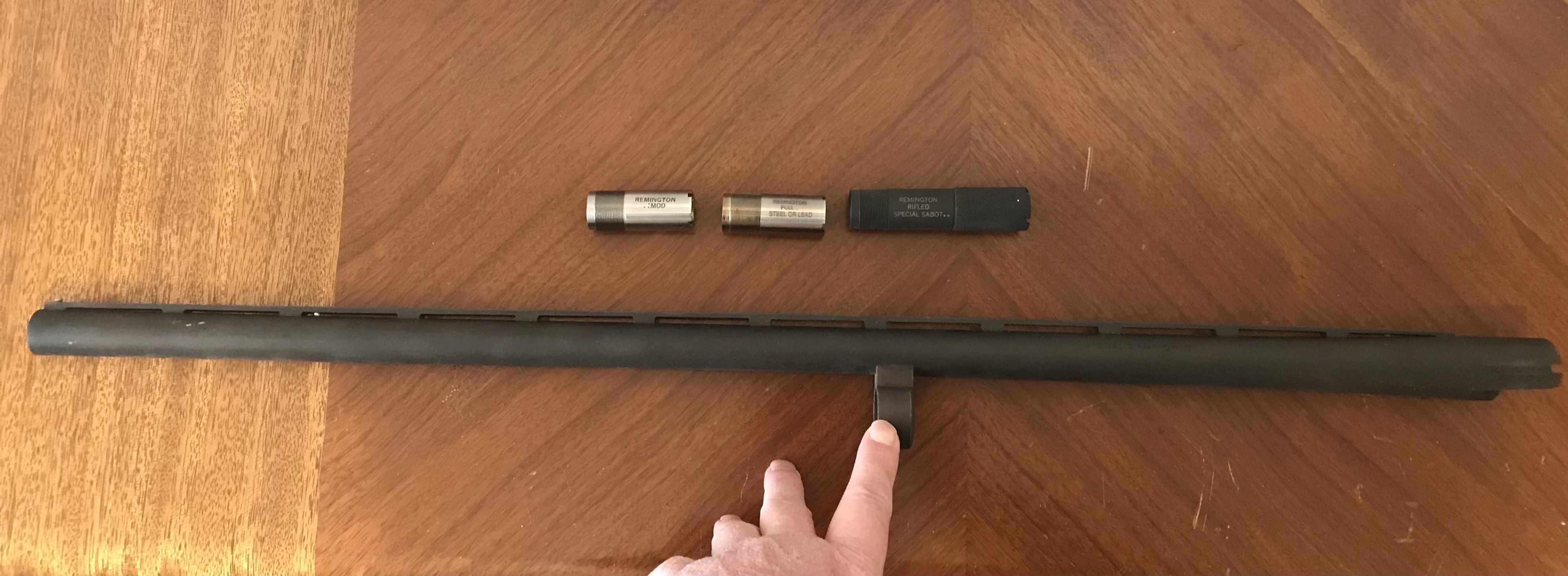

Got a used 28” barrel with chokes so I can trap shoot with less embarrassment.
Came with a Mod choke, Full choke and a Rifled Sabot choke.
What I don’t have is a choke wrench. .... so ... Questions !
1. suggestions for a decent choke wrench?
2. how tight does the choke need to be?
3. Do I need for a anti-cease lube on threads? Or just light oil?
4. I’m assuming Full choke for Trap shooting?
Thanks for the help
