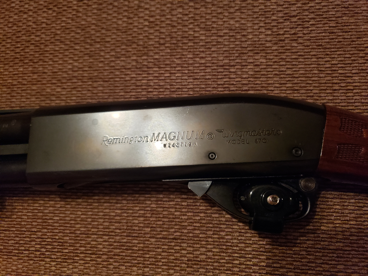

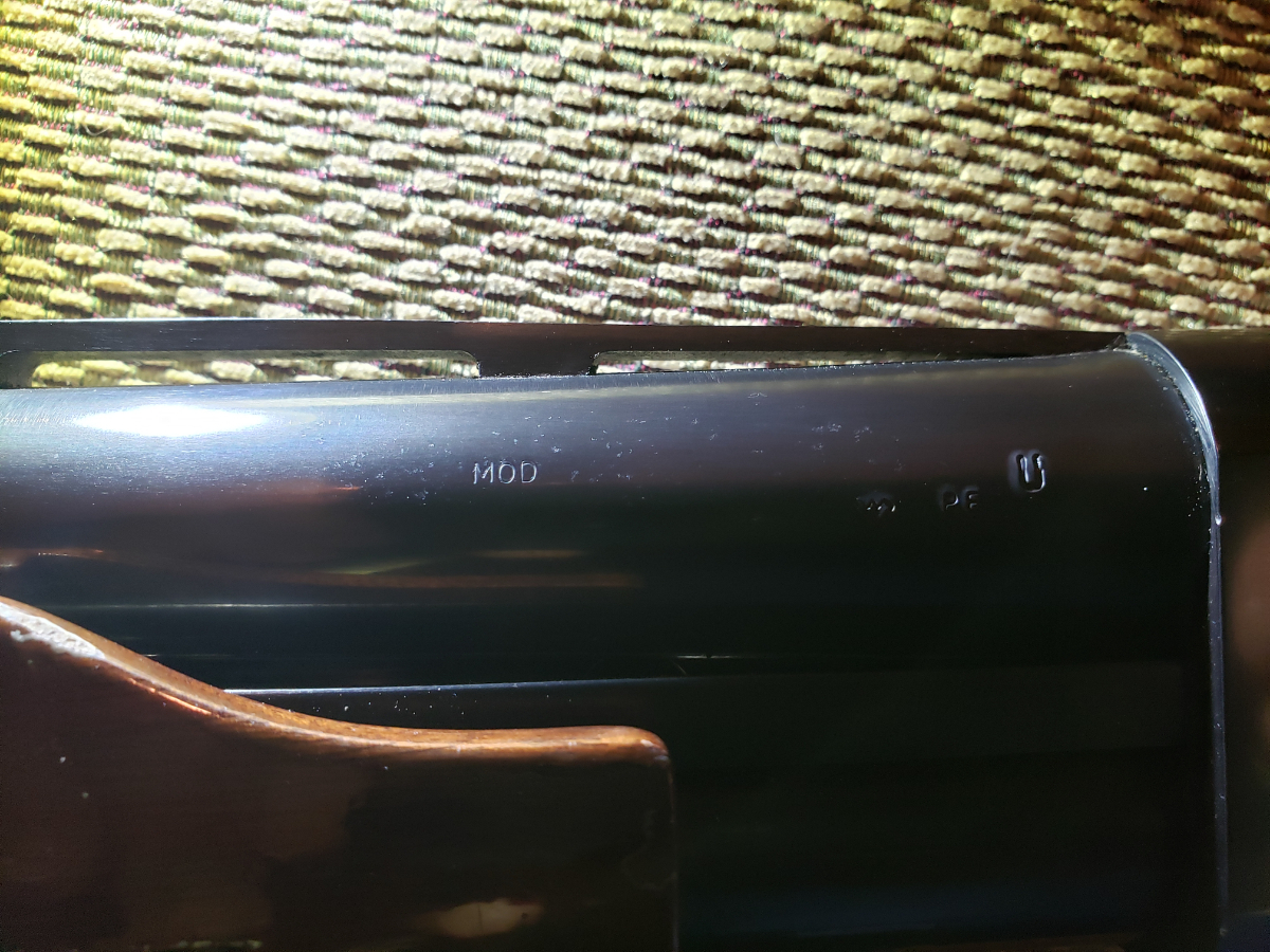

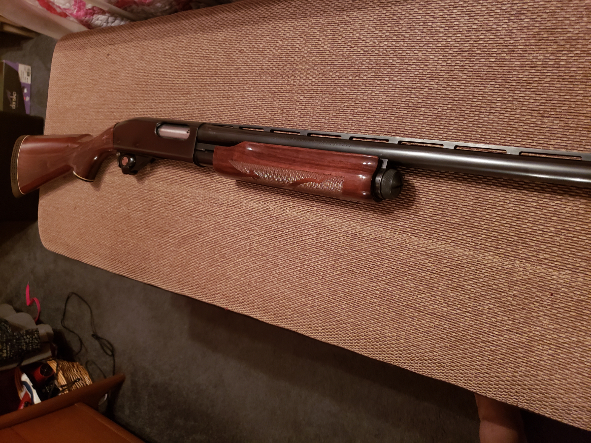

Hey guys, new to the forum so thanks for having me.
I’m looking at purchasing the Wingmaster in the photos. Been doing as much research as I can but I figured I’d ask some of you experts. From what I have determined, based on the date code, I’m thinking this model was made in 1984? Is this correct? Also, would this likely be the original barrel with the gun? Finally, I’m assuming yes, but would it be ok to shoot steel out of this barrel, I am assuming where is says mod, means it’s a fixed modified barrel? Finally, if need be, could this barrel be threaded to accept other chokes down the road. Thanks so much guy.

Howdy and welcome! That's a good looking Wingmaster, so I hope you don't plan to do some HD mod to it. Yes, the barrel is rated for steel, and if the choke is fixed, then there's no issue with steel shot. If the choke is removeable, then you'd have to see what choke is in there and it's capabilities. In general, older Wingmaster barrels can be rebored for removeable chokes.

No, it's a good point of discussion. To my understanding, most of what rates a choke for steel or not-for-steel is the interface where shot strikes the choke and narrows into the restriction. In a solid choked barrel, there isn't any interface such as there is with a removeable choke. Otherwise why would the choke need to be rated for steel and yet the barrel says nothing about lead, steel or bismuth shot. None of my Remington barrels say "Lead shot only", so a steel-capable barrel with an integrated choke should handle steel shot too? That's my deductive reasoning.
