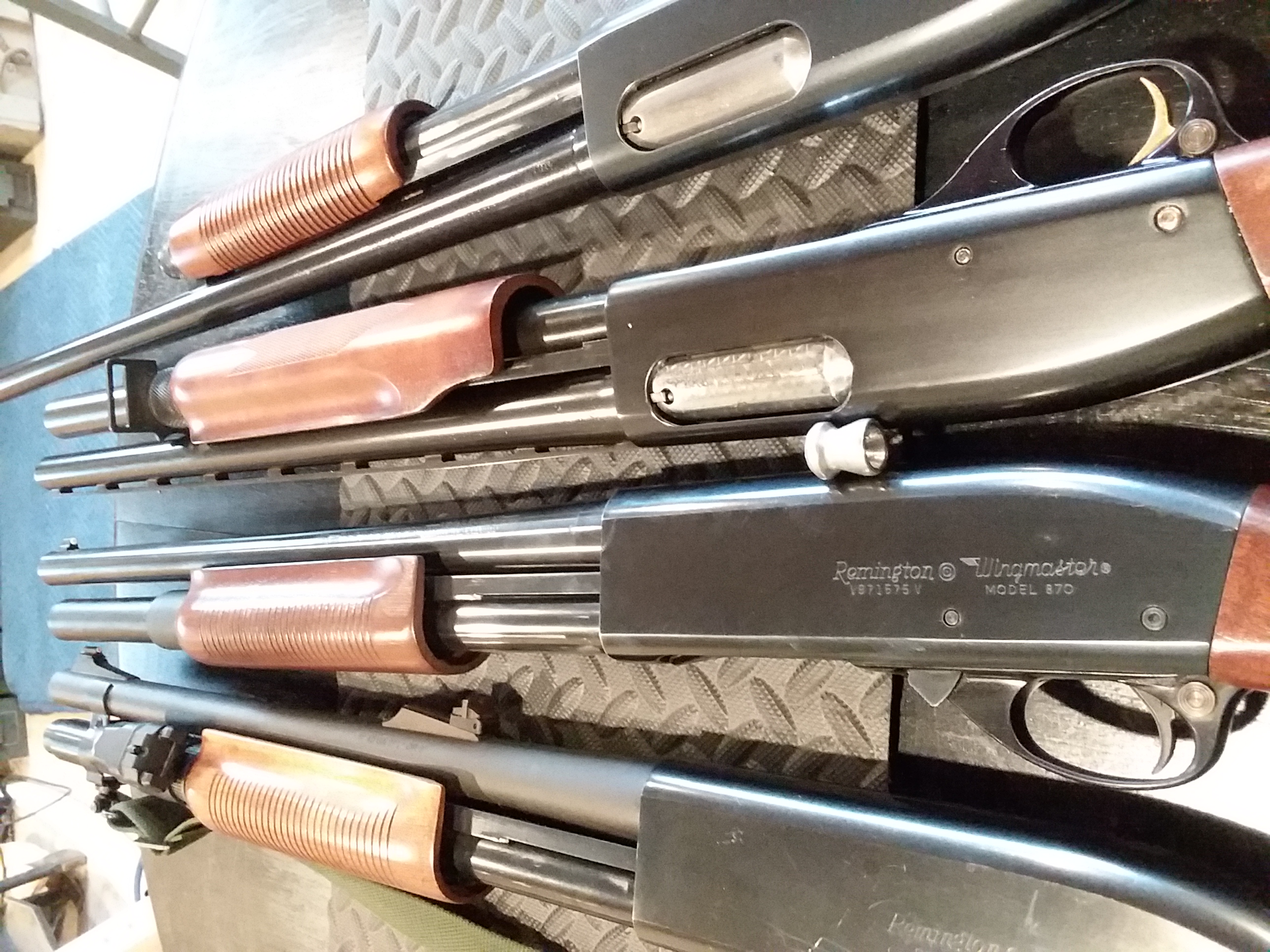

Pictures of slugs and garbage can would be fun.

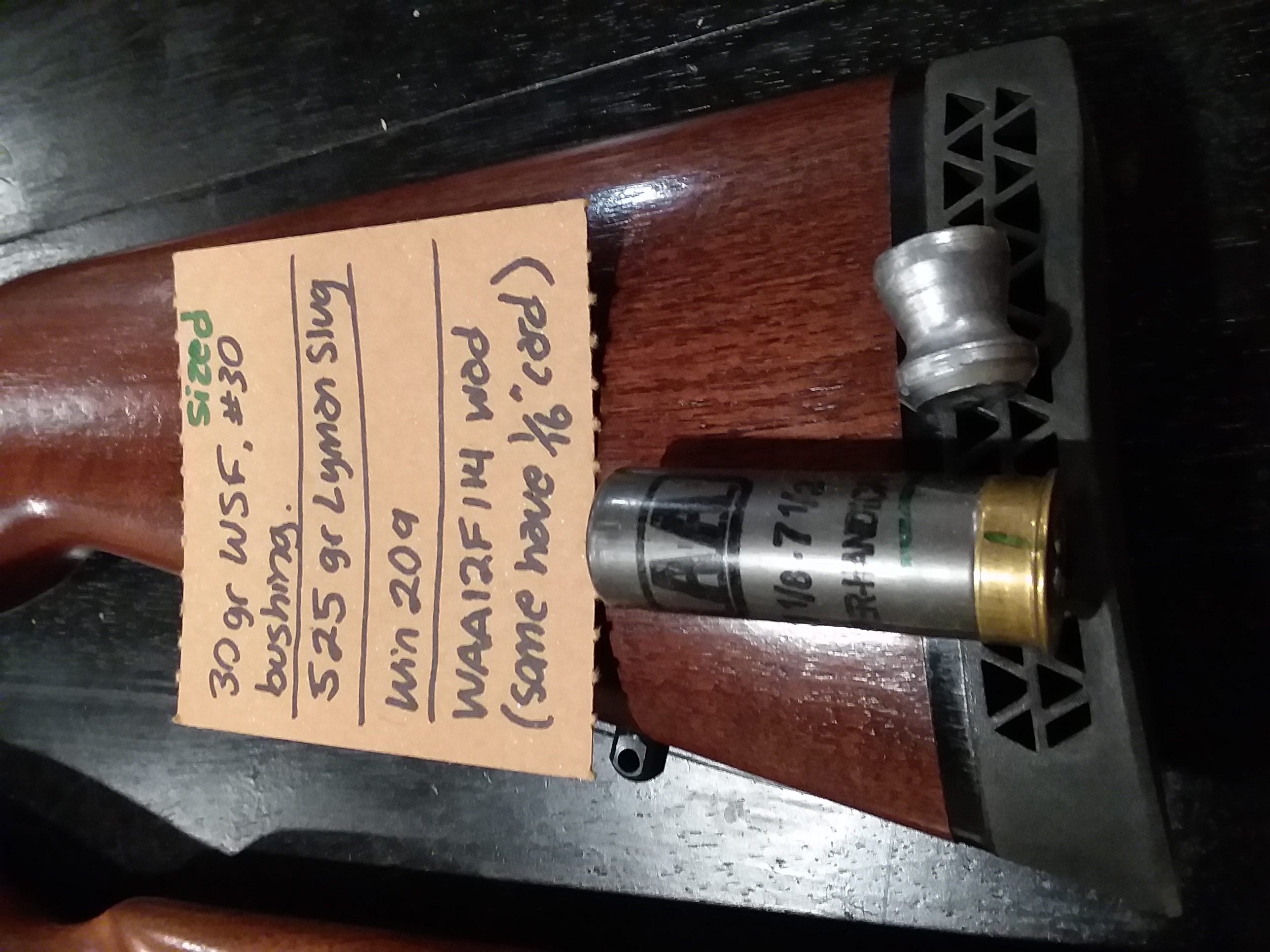

Here is a slug. Don't know anything about any "Russian" slugs but these American lead slugs cast by an American on an American made Lyman mould seem to work well enough. Is there a reason to go with Russian options?

Here is the card I put in the ammo can. Refer to an actual book, mine is in attic or I'd photo actual published data. This card should represent a published load but I make no guarantee. My team of lawyers tell me I should say that.
