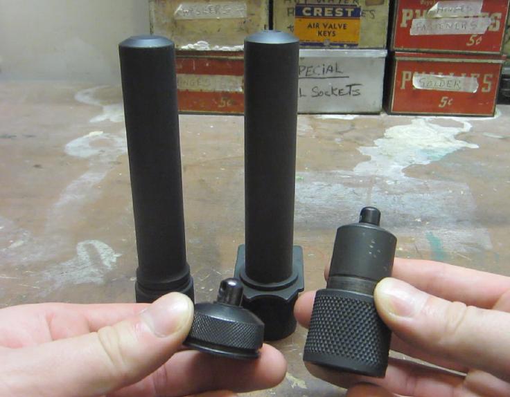

Well, what you're describing pretty much just sounds like a +1 extension. Yes, mag caps vary somewhat, but I'm not sure you're going to get enough extra space out of one to reliably fit a fifth shell. +1 extensions aren't terribly expensive, are generally easier to get to run reliably than longer kits, and get you that fifth shell without crushing your spring to the limit or requiring you to fiddle with your ammo or other magazine parts. They're also generally designed to match up with 14" barrels, making them significantly shorter than even +2 extensions, and really not much longer than a magazine cap. You mentioned in another thread that your 870 is a 7+1 Police model, which should have a 20" barrel if it's still in its factory configuration. A +1 extension won't come anywhere near the muzzle on that barrel.
extensions cap comparison.JPG (48.03 KiB) Viewed 3698 times
If you're really set against installing an extension, go ahead and play with caps, but don't expect anything but very minor differences. Removing the spring retainer (if your gun has one), playing with the spring, and using a space-efficient cup-style follower are other ways to squeeze a bit more usable capacity out of a standard-length mag tube.
