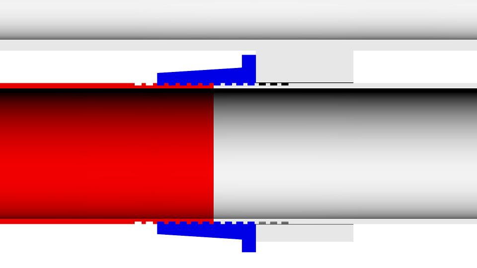

Re: Disappointed
jampony17 wrote:870 Express Tactical, 18.5 barrel, 2 shot extension tube, ghost ring site.
That extension may be what caused the issue with the barrel. Remington factory extensions are two-piece, with two male-threaded tube sections butting together inside a female-threaded coupling that also serves to secure the barrel:
2-pc ext.JPG (29.33 KiB) Viewed 4705 times
If the extension's loose out of the box (not too uncommon, it can happen during shipping, or if someone was fiddling with it in a gun store), and it comes loose, it has to be tightened back down in a specific way, or the barrel may not be secured properly even if the extension seems tight.
As for the front sight, yeah, that's probably Remington's screw-up.
Hope it all works out for you; 870s are great guns.
