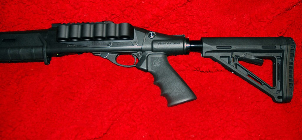

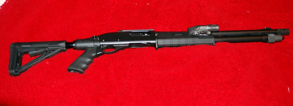

I was thinking of picking up a 6 shot synthetic, and getting it cerakoted and adding the sights, and the shop had a black Magpul edition I fell in love with, so I grabbed it.
Installed a Mesa LEO and crosshair hydraulic buffer tube with Magpul carbine stock.
Just ran 25 rounds through it, and I can't believe how great that buffer works.
For anyone considering this stock, just do it!
My 135# wife fires it with no problem.
I love this thing!!!
I've got a Wilson Combat +1, Mesa sidesaddle and a Inforce WML that I'm gonna put on tomorrow.

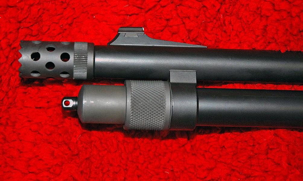

The only issue is the "off color" of the extension.
The Cerakote finish on this weapon is awesome! I would like to find someone close by who does Cerakoting, and get the extension, and the Mesa LEO adaptor done so they match,

- DSC_5593.jpg (84.74 KiB) Viewed 6075 times
- DSC_5598.jpg (175.95 KiB) Viewed 6075 times
- DSC_5597.jpg (107.18 KiB) Viewed 6075 times
