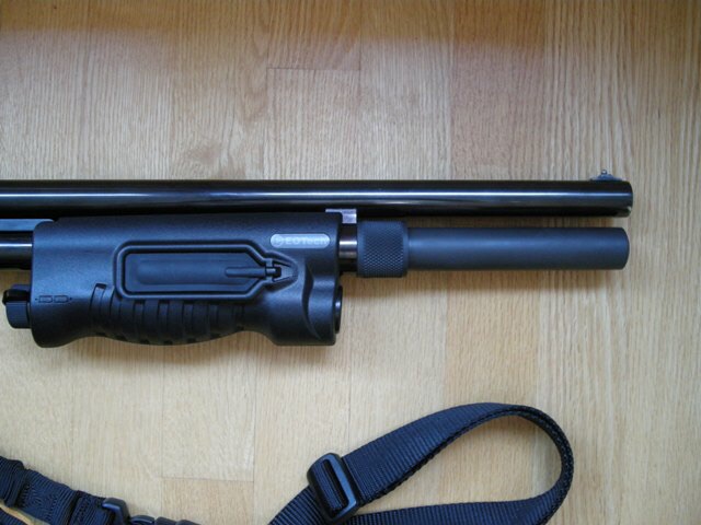

I just added the Wilson +2 without the sling mount, and couldn't be happier.
Installation was a breeze.

Hey Dale, i'm ordering the exact same extension in a couple of days; the Wilson Combat +2 without the sling plate. In your picture it extends out even with your barrel, are you using an 18" barrel by any chance?? Just curious because i have an 18" barrel on mine...
EDIT: I got my Wilson Combat +2 mag ext. and it does install quick and easy and you're in business. I did the simple "mod" Synchronizor suggested and it works like a charm.
