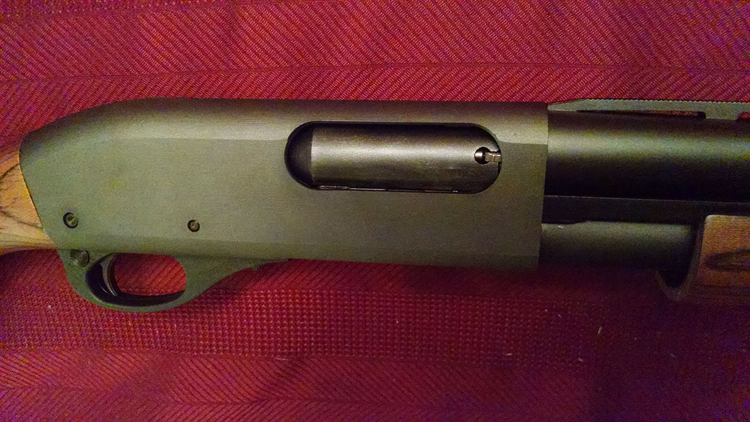

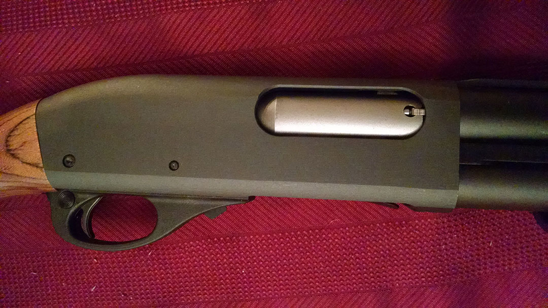

I've always loved the way the Wingmaster looks. Between the blued receiver, the walnut wood, and the polished bolt, its great! I wanted to get my 870 Express to look a bit more like that. The biggest eye sore for me was the black oxide bolt carrier. I only have about 100 rounds through the gun, along with a bunch of extra pumps to work the action, and there is already scuffing. I decided to try to remove the oxide (Blue and Rust Remover), and polish up the bolt to see how it looks. Worst case scenario, I could always cold blue it again, or even buy a WM bolt.
Here are the results. I haven't decided how far I will polish it yet, and getting the shiny look of the WM bolt will not be easy. I'm also not too sure how it will react to not having the blue to protect it. I figure if I keep it maintained, and properly oiled, I shouldn't have much problem with rust.

Were you able to polish it to a more shiny finish? I was wondering if I need to use sandpaper, or just different polishing compounds to get it less dull. I used steel wool which did great at taking off the oxide, but did not do much in the way of shining it up.
