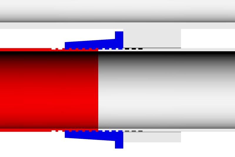

This is a Remington factory extension, right? Those extensions can be finicky if you don't install them properly. Install the coupling by itself first, then insert the magazine spring and thread the extension tube into the coupling. The key is to make sure the magazine & extension tubes are butted directly against each other inside the coupling. Otherwise, there'll be a gap that can cause the follower to hang up.
rem extension mate CS_SC.JPG (24.41 KiB) Viewed 4821 times
Also, make sure you have the right bracket for your particular barrel. If it's the wrong one, it could be pulling the extension tube out of alignment.

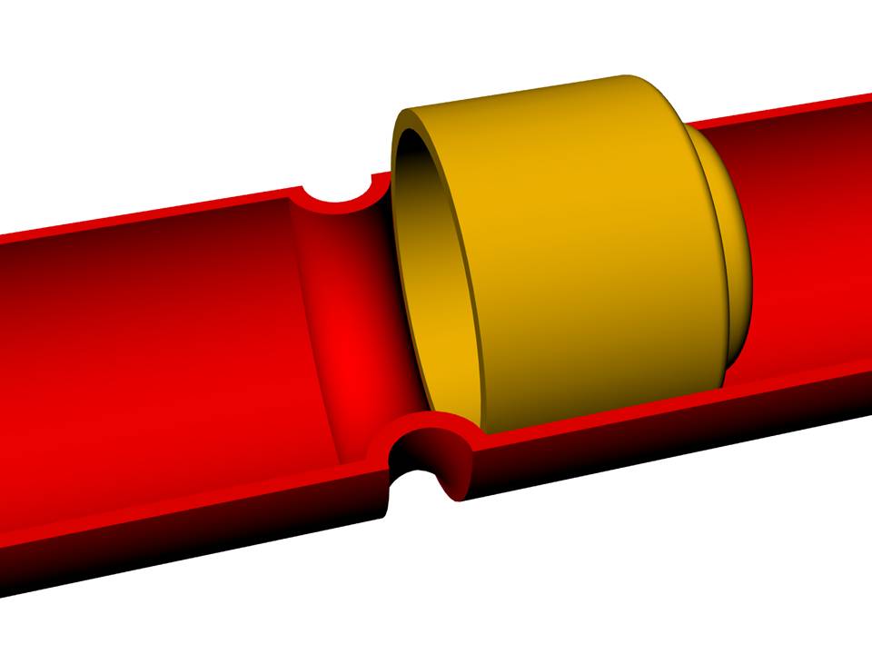

Actually, the bracket groove in the Remington extensions also serves to stop the follower before the spring can become overly-compressed. So unless you're using an aftermarket follower with a solid body, you should be fine loading whatever'll fit.
