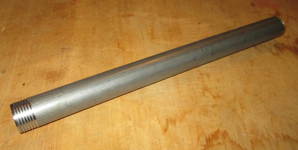

You use silver solder to attach the extension tube to the coupling?
I measure the thread pitch to be 12 turns per inch on my magazine & extension tubes. You shouldn't need to bother cutting the threads if you want to produce +1 extension tubes, though. Unfinished magazine tubes are just $10.30 each, and they already come with threads machined into them. Shorten, cap, finish, and there you go.
870 mag tube (bright).JPG (69.1 KiB) Viewed 6633 times
