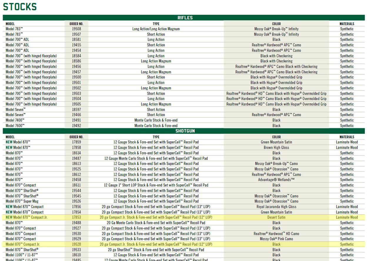

Remington makes 12" LoP stocks for their 20ga Express Compact Jr 870s. You should be able to order one of these from their parts department, just make sure they understand you're after the 12" junior stock, not the 13" compact stock. I can try to track down a part number if you'd like, but Remington's parts list doesn't give the LoP for most of their stocks, so I'll have to cross-reference it with some other documentation to have any degree of confidence, and you'll still want to double-check with Remington anyway. If it helps, I believe the order number for that junior model is #81161 (or at least it was in the 2013 catalog).

Here's the stocks table from Remington's 2014 catalog, with the 12" LoP 20ga 870 stocks highlighted. I believe these are full stock packages with mounting hardware
and recoil pads, so they wouldn't line up with any one entry on the parts price list. I have a SuperCell pad for my 12ga 870, and it's extremely comfortable.
Page 135 of the Remington 2014 catalog
