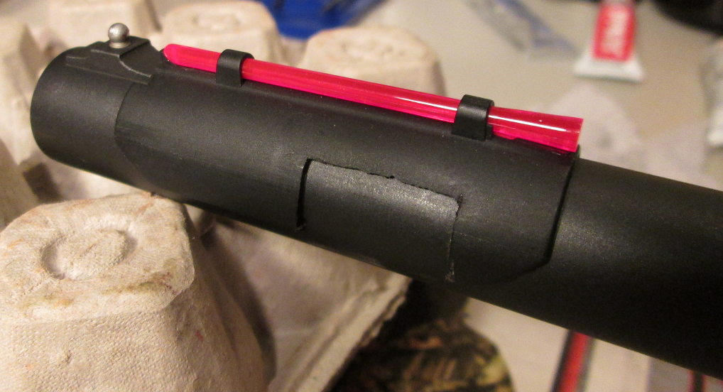

A vent-rib is a good way to go since it's already there, but if that's a huge turn-off for you, there are some other easy options. One I've used is a clip-on Hi-Viz front sight. It's not the most solid or durable thing out there, but it's cheap, easy to install, and a marked improvement over nothing at all.
hiviz front sight red.PNG (1.35 MiB) Viewed 3923 times

That's pretty cool!
