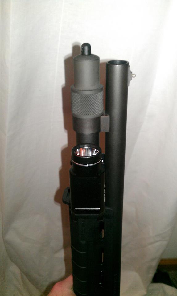

interesting, what did you use for a spacer? any pics?Randomguns wrote:Hey, Just FYI. I have a (don't anybody shoot me) Chinese knock off of an 870 that I bought as a "tool" that I could throw on the floor of my truck and not worry about it. It has an 18 1/2" barrel similar to yours and Turns out I can take the barrel off of my 870 and put it on with a spacer that I made that fits over the mag between the nut and the ring, works great. I also shoot trap with it just for fun and does just fine.

Ammo capacity for shotguns include the chamber; a 5-shot gun would be 4+1, for example. The long-mag-tube 870s like yours will hold 6 standard shells in the magazine, plus one in the chamber for a total of 7. If you want more capacity, you can put magazine extensions on those guns just like a standard 870; the tube is longer, but the attachment system is identical (you may need to use a different mag spring, but those are cheap). A +1 will fit fairly well, while a +2 or longer extension will extend significantly past the muzzle, which isn't great for a defensive shotgun.Benjammin wrote:Hey so, another stupid question here, I just bought some ammo for the first time, and was just testing out everything (loading in ammo, cycling it, ejections, etc) and can only fit 6 (2 3/4") shells into the magazine. I realize that with one in the chamber, thats a total capactiy of 7, but I was previously under the impression that the mag was suppose to hold 7 shells, and the one in the chamber would be extra. Is that not the case with these models? or should I expect some break-in time?
