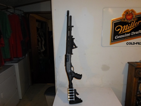

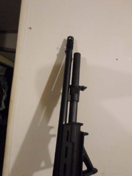

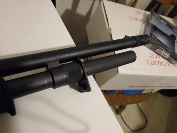

I currently use the Wilson Combat 2+ shot kit. I love it, no issues with loading its solid and well made. I like the spring and follower that came with it, also it allows me to load all 6 shells into the tube unlike my Remington +2 shot kit that I did have installed on there. It kept coming lose and after the first 6-7 shots it would not allow me to load all 6 into the tube.
The Wilson combat looks better runs better and was at a better price point than that of the Remington kit. Rem Kit 52.99/state tax, Wilson Combat 45.00/shipping. If I remember I think I got free shipping. Here are some pics of it installed onto my shotgun. I kinda wish I went with the 3+ kit instead because of the barrel room I still have.
Well I might have spoken to soon, I am now back from the range and put about 30+ slugs through it and the metal plate now rattles like hell and it came loose for the first time. I want to use this for deer hunting and rabbit also but with that plate rattling around not good for hunting now. I have tried everything to tighten it down and it's on there but that plate still rattles. I have noticed that there is also no way to remove that steel plate. I got it from Brownell's and I just contacted them and they just said return it for a exchange or refund. I am going with the Choate 3+ mag tube kit. I chatted with one of there online guys and he uses the Choate on his 870 and it has never loosed on him at all. Also no metal plate rattle. I will let you all now about the Choate model when I receive it. This will also give me 1 more shell in my firearm instead of 6+1 I will have 7+1 I like that better. The only difference is that the Choate comes with a Mag tube clamp and the Wilson Combat did not, but the Choate has gotten better reviews so far.
Re: Looking for Input for a +2 Magazine Extensions Review
The rattle in the sling plate is an unavoidable consequence of its design concept. There's simply no way to manufacture a plate that is a perfect fit to every 870 barrel right out of the box. If you make it too tight, most of your users will have to spend an evening fitting and refinishing it themselves. If you make it a hair loose, it might rattle a little, but it'll still function fine. Tightening the extension will have no effect on the sling plate, obviously, as the plate is in front of the extension's base.
You can remove the sling plates on Wilson Combat extensions if you grind off the welds that hold the retaining ring on; that's been done to my WC +1 extension. If you don't want the sling plate at all, this is a recommended step. WC extensions have a standard outer diameter, so there are a number of clamp-on sling attachment accessories that should be compatible.
