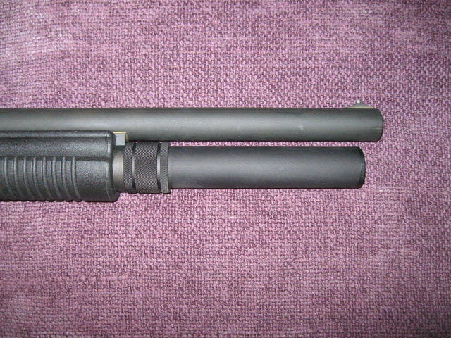

I ended up buying an ATI one piece aluminum +2 extension with spring. Found it at a hole in the wall gun shop in a town that I had taken my wife to for a specialist visit. Got an awesome deal on it too! This extension is going on a 870 that is NOT my primary HD weapon. Seems very well made of heavy gauge aluminum and carries a lifetime warranty.
- IMG_0019.JPG (181.96 KiB) Viewed 3949 times
