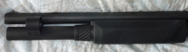

Today, I installed my Nordic extension, CDM clamp, and Hogue short stock. Everything is awesome, and I was hoping to get 7 rounds in the magazine now like many others have said (I bought the XL end cap for the extension) but it's only holding 6. Yes, I drilled out the dimples completely, but I did only cut the spring to 16" remaining out of the extension. Do I need to cut more? Should I just leave as-is and be happy with 6+1. I'd like to squeeze another in there, but not it if means it'll be less reliable.

tpattgeek, got photos? Tell us which extension have you got exactly? I have +3 extension and it works properly. I have cut the spring but not much.

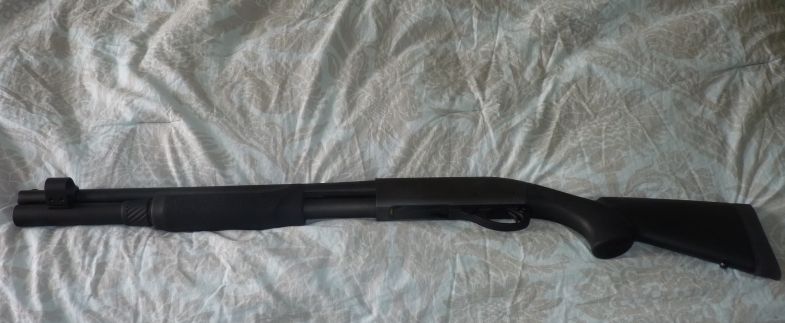

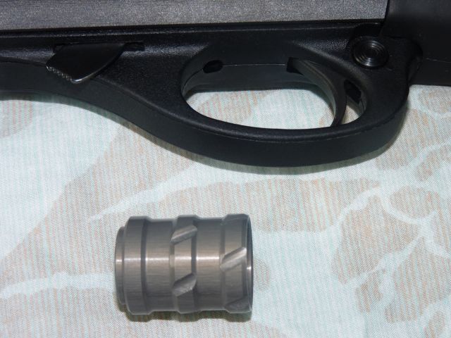

Here's some pics of the Nordic Components teflon-coated aluminum follower I received today along with the +2 extension and extra long end cap I installed yesterday :)
My issues are no longer extraction related. My local gunsmith honed and polished my chamber under warranty and it extracts everything I feed it now. However, it's still stove-piping some rounds, and the ones it doesn't, they just drop out of the receiver like they were just flicked. If there's something I can do to the ejector to make it function better, I'm all ears.
Re: My Nordic extension doesn't hold 7+1 like others do...
What extractor do you have? MIM or non-MIM?
Here are some pics which show differences:
