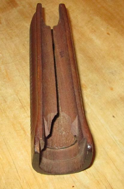

Since you have a wood fore-end, you'd probably be best off modifying it. There's really no need to shell out for a whole new fore-end unless you actually want a different style, or you want to keep your factory one intact.
Like Zebra62 said, there are two ways to approach this; leaving the fore-end long and only removing material where it would interfere, or simply chopping the back of the fore-end straight across to make the entire thing shorter.
The thread EdwardE linked earlier shows a good example of the first approach. Zebra62 removed just a little material from one side of the fore-end on his wife's 870 so it would clear the Mesa Tactical sidesaddle.
However, the AIM sidesaddle is a lot wider than the Mesa Tactical, so you may have to remove a lot more material. This video shows an example of the same type of fore-end modification to accommodate a TacStar sidesaddle, which is pretty similar to the AIM (ignore the guy's bellyaching about the long fore-ends in general though; there is a reason Remington and others use them on sporting guns). The way I see it, if you have to remove that much material, the remainder is no longer a practical place to grip the fore-end. If you try, you'll just be pinching yourself, or knocking your hand against the sidesaddle and short-stroking the gun. In that case, I'd suggest simply shortening the entire fore-end, effectively making it a riot-style piece.
PW Foreend_small.JPG (42.28 KiB) Viewed 6365 times
PW Foreend_I.JPG (42.98 KiB) Viewed 6365 times
Or, if you prefer to place your support hand farther back (which is the point of the longer fore-ends), there are 4-round sidesaddles that will work with the longer fore-ends. In my mind, 2 fewer rounds on the side of the receiver is not a bad price to pay for a better-fitting gun that you can use more effectively.
