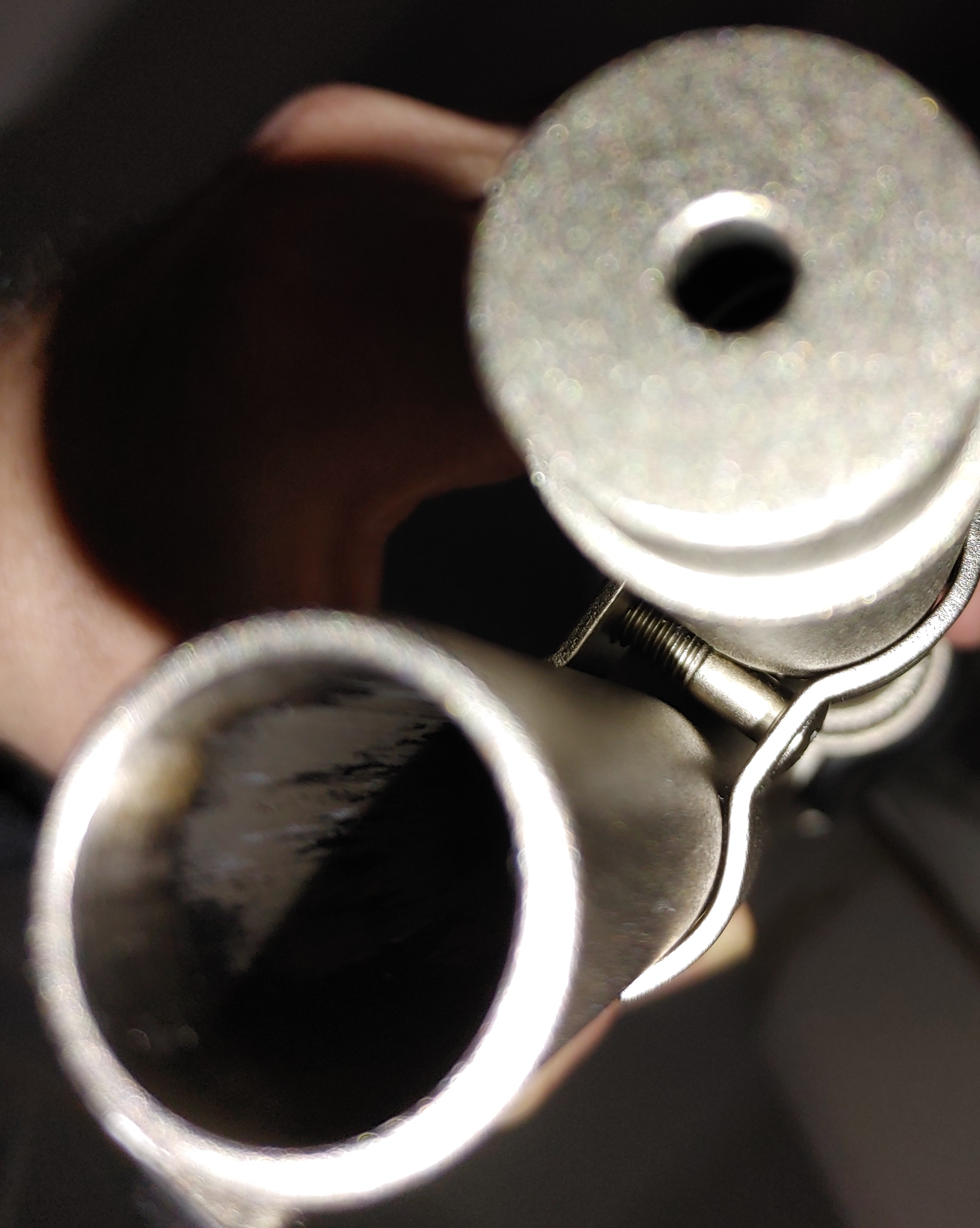

I have a little cleaning related problem with my two 870 Police shotguns. One is 9 years old police model with wood furniture and the other one is 3 years old police marine magnum. It's a genuine police marine, made in Ilon, NY plant with 25047 number. It has smoothbore fixed cyl barrel with rifle sights, forged extractor, metal trigger assembly, steel mag tube spring and other features which indicate that it's actually a real PMM and not regular 870 marine.
It shoots great, they both shoot great with every type of shotshells, but i can't get the lead deposits out of the barrel no matter what kind of a cleaner or technique i use. I mostly shoot heavy stuff through it. 00-000 buckshot, foster slugs and a few brenneke 3" magnums here and there.
I've used hoppes No9 (although i try to avoid agressive solvents with ammonia in them), Milfoam forrest foam, balistol oil spray and boresnake. I've managed to remove 50-70% of lead out of the barrel but the rest just wont come out.

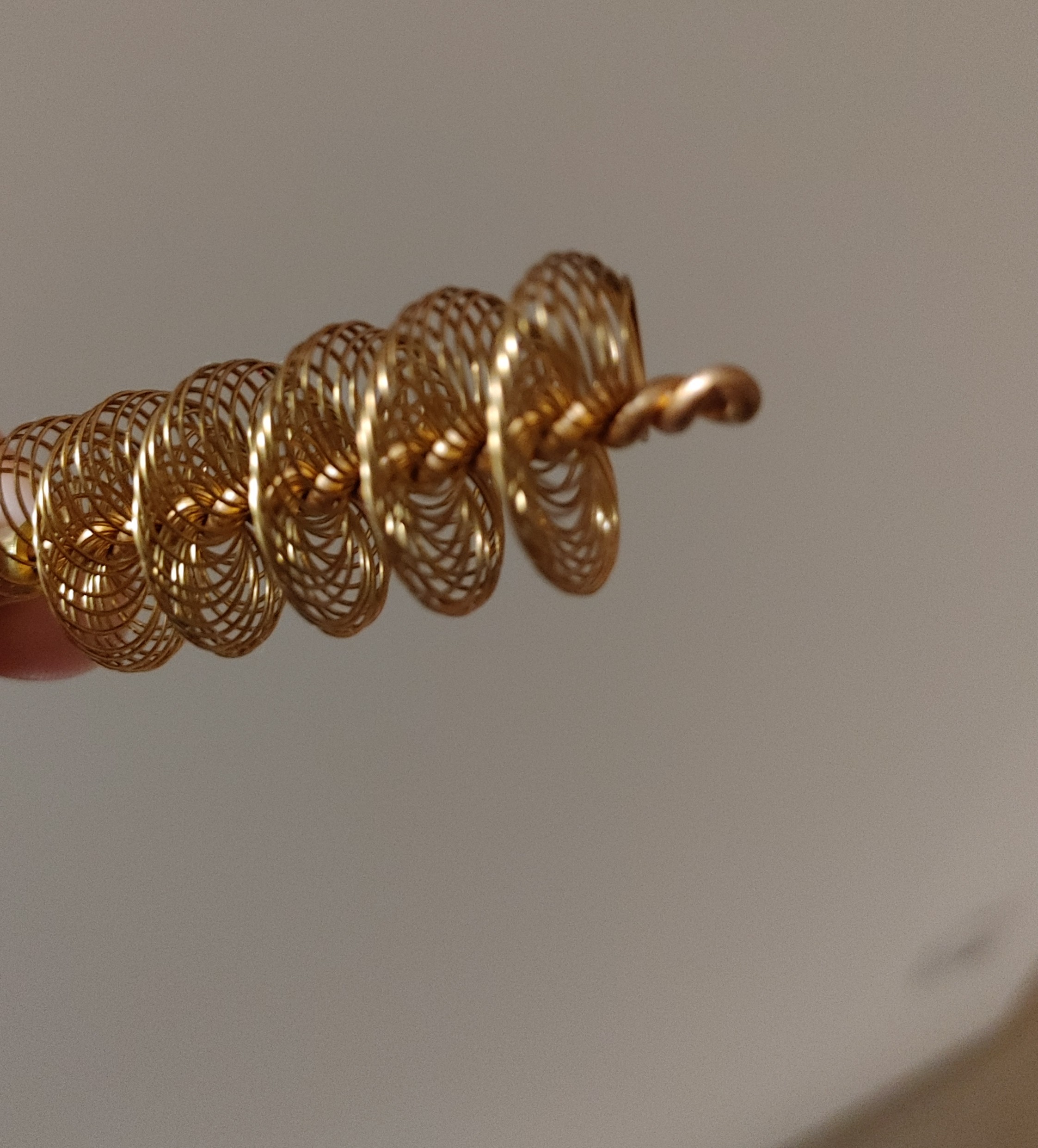

I don't know what kind of barrel finish does my police marine has, but i read somewhere it is polished, while my other older police model is not? The only option i have left is a tornado brush i just purchased, but i'm afraid of scratching the barrel polish on PMM with this hard (steel??) tornado brush.
What do you guys suggest? Should i try a tornado brush or should i just accept the fact that certain amount of lead will be forever in the barrel. Is that bad long term?
Appreciate any help with this. Thanks

Once fouling is loose, then you can generally use a tornado type brush to pull the fouling out. The tornado brush is basically a screen like weave of metal the pulls the loose fouling off the barrel. You need to break up the fouling with the borebrush and solvent in order for the tornado brush to pull the loosened fouling away from the barrel.
When it comes to tornado brushes, there are generally 2 types, one is the stainless steel one from Hoppes, the other is a copper based one from companies like ProShot and Boretech (There may be others but that is what comes to mind at the moment). The Hoppes being stainless steel is harder than most barrel steel, and can scratch it, it is what we use on Police shotguns, but not something I would use on a high end custom Italian sports car gun that cost $10k or more, as the stainless could scratch the barrel. For the high end guns if I am afraid of leaving a scratch in them, this is where I opt for the copper bristle ones, as the copper or bronze phosphorous ones are usually softer than the barrel steel and won't harm it.

I must mention that i mostly shoot foster&brenneke slugs and italian made 00 9 pellet buckshots (fiocchi, B&P) that don't use traditional cup for shells like some US brands like Federal or Remington 8 shell buckshot. These brands use roll crimped shells with plastic bior wad that is under the shells and don't hold the shells in the cup.
Thus the pellets (and slugs for that matter) come within direct contact with barrel walls. Unfortunately i can't get a hold of cup shotgun shells from Remington or Federal, because i'm from Europe and here we have mostly italian shotshell brands which for some reason (don't know why- but it really makes me wonder) all use plastic bior wad. Only little target/trap shotshells have a cup. Which i never shoot since i'm not into trap/skeet.
So this is not plastic deposit what you see on my photo of my 870 PM barrel, but pure lead. Which is a nightmare because it wont go out. I own 5 shotguns and these lead deposits are the worst with two 870 P models and benelli M4.

Just want to ask if the bristle brush is safe for the polished barrel of my 870 PM? It wont scratch the polish off?

A bronze/phosphor-bronze bristle brush is safe for the polished Police Magnum bore. It won’t remove the polish or scratch the steel in any meaningful way—Remington barrels are a lot harder than people think. What will mark a bore is steel brushes or stainless tornado brushes, which I’d personally avoid unless things are truly desperate.
