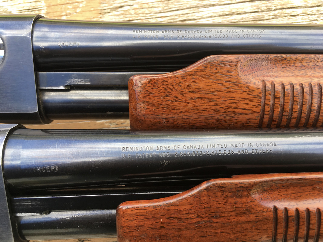

Only the barrel, but the barrel is original to the gun, rollstamp on barrel is identical to my us made wingmaster except it says "Remington Arms of Canada Limited Made in Canada", with patent numbers below.

The easiest way to spot a Remington Canada 870 is usually the barrel, they will be marked Remington Canada in place of the usual Remington Arms Ilion NY, and the REP proof mark is replaced with RCEP. I know of about a dozen of these guns including around 4-5 I've had through my hands and had a chance to take apart. They have all been identical in every way except for variations in barrel date codes and that one was a 28" mod and the others were 30" full. Most had 4 digit serial number with a V suffix between 1200-1700 serial number range, although i did encounter one in the 12k range and one in the low 100k range, (Ilion made 870's got to that serial number by 1951).

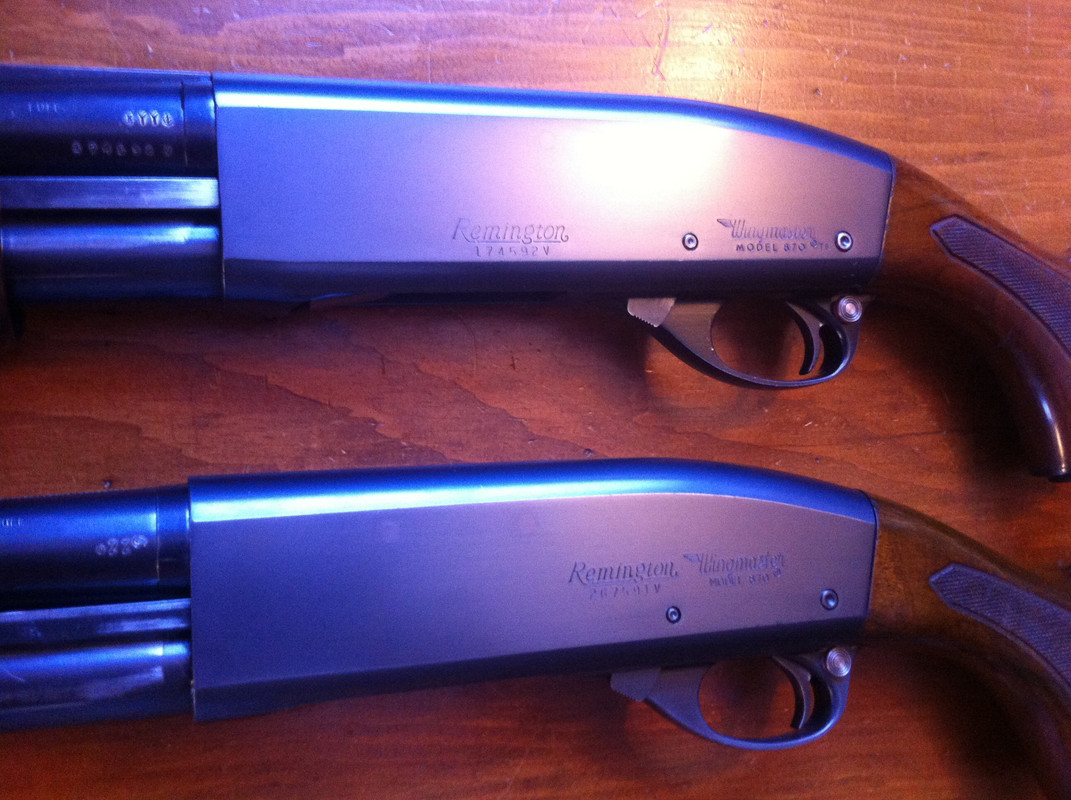

For the first few years of production Remington had some variations in design that changed through the years. A few of these changes include the lack of a removable steel plate between the butstock & receiver, this was later added to stop stocks from cracking I believe. Very early guns also did not have a retaining pin the kept the locking block from falling out of the bolt when field stripped, it was a change that happened very early as the earlier design it was very easy to accidentally assemble the gun without the locking block. Another chance was the serialization of the barrels to the receiver, I believe this was discontinued around the 200k serial range, or roughly 1952-53. Also around this time Remington moved the serial number/Remington stamp from near the edge of the receiver & the Wingmaster logo from between the trigger mech pins. The Wingmaster logo was moved up a little higher, & the Remington stamp/serial number moved next to it. At some point in the late 1950's Remington also changed there method of bluing, although I am not sure the exact year. The earlier bluing was a lighter color, also the bluing does not appear to be inside the receiver, is more of an exterior finish only. The later bluing method is a more commonly encounter nowadays which is an immersion bluing that is on the inside & outside as well as being a noticeably darker almost black color.

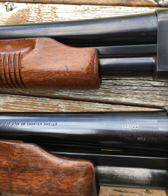

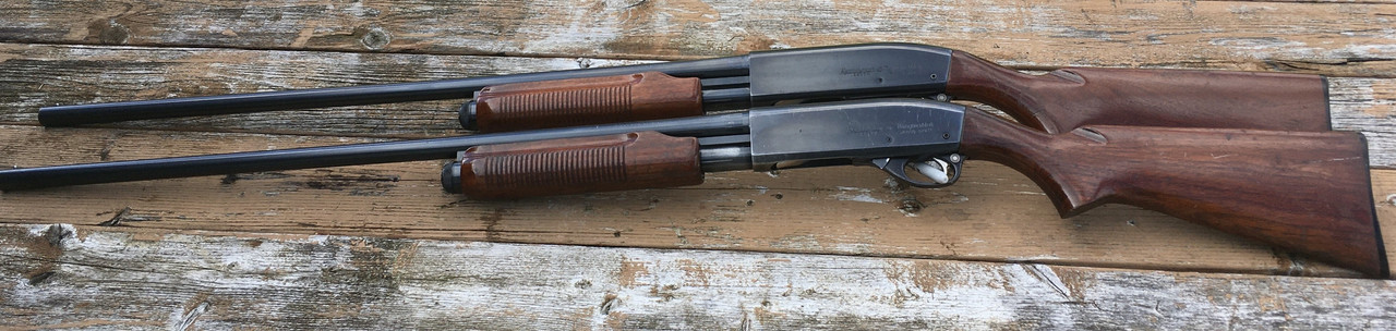

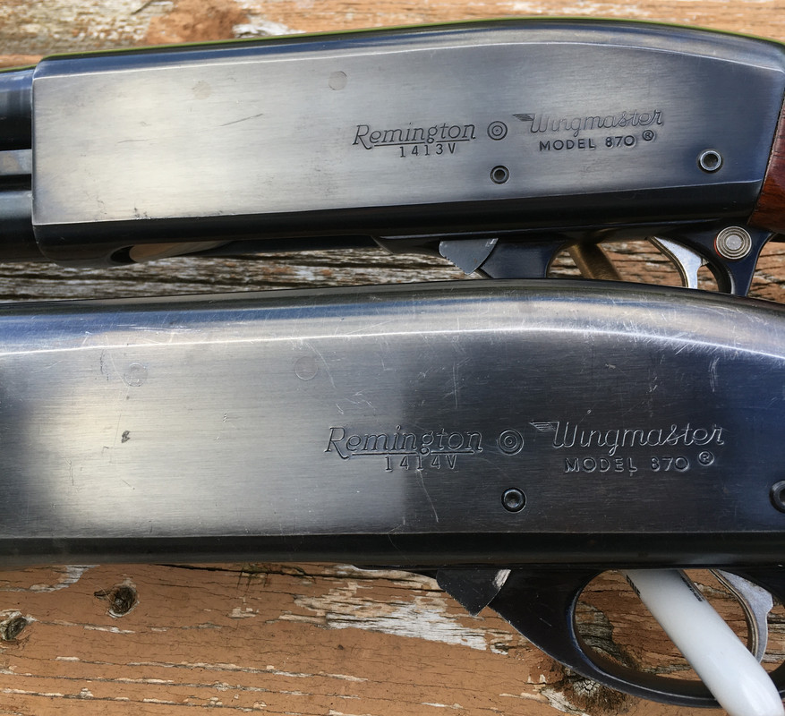

Here is a pair of consecutive Remington Canada 870's I managed to track down.
Examples of the transition in receiver stamps in 2 guns a year apart.
