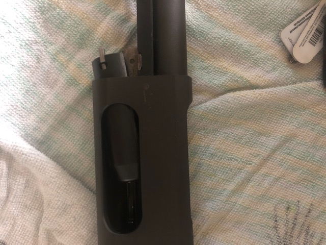

Bolt&Carrier Jammed in Receiver
Post by dtm4655 » Sun Sep 27, 2020 8:21 pm
I have a Remington 870 Tactical and one of my friends was trying to take it apart and show me how to clean it when he was taking it apart (obviously he didn't know what he was doing) the bolt and carrier came apart and became lodged coming out of the receiver.... I will attach a picture but is there any way to fix this issue.. I can't for the life of me find anything to help me out with it!

Wow, that’s a winner. My thinking is you need to tap the carrier back while tapping (Or pushing) the bolt forward at the exact same time until the carrier is back under the bolt WITHOUT wedging it in any tighter.

A more detail thought on how to fix this Is ..
Put the handle of a screwdriver in the port and hold and use the shank to have the (plastic or wood) handle lever the bold forward with light pressure, while using another tool (small tack hammer) to tap the carrier back under

I think this is a two-step process. First, get new friends who know what they're doing. Then remove the forend so the rails aren't sticking into the bolt-carrier area if at all possible. Then I think it should all drop out.
