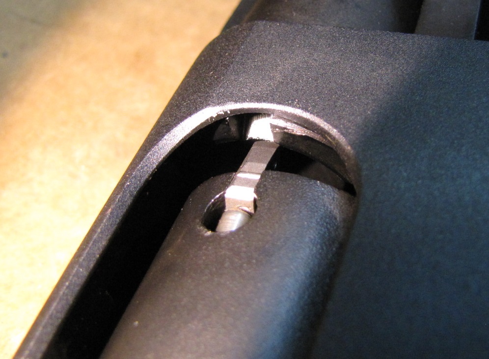

Here's a pic of my 870 Express slug gun, and as the bolt almost engages the extractor cut. Have you tried a different barrel, or install the Volquartsen non-MIM extractor?

I'm not a gunsmith. So for what it's worth.
I tried with thumb pressure on the bolt and I can't get mine to line up like that. I ain't gonna try a screwdriver for more leverage
The bolt is fairly loose until the last couple of millimeters and then it firms up and the extractor lines up with the cut.

Scorpion, thanks for the excellent picture. That looks better than my situaton. The extractor seems firm but the bolt does seem to perhaps turn depending on the orientation. The gun is completely stock and under warranty. The gun is new so nothing should be worn. Never been fired with any ammo.
