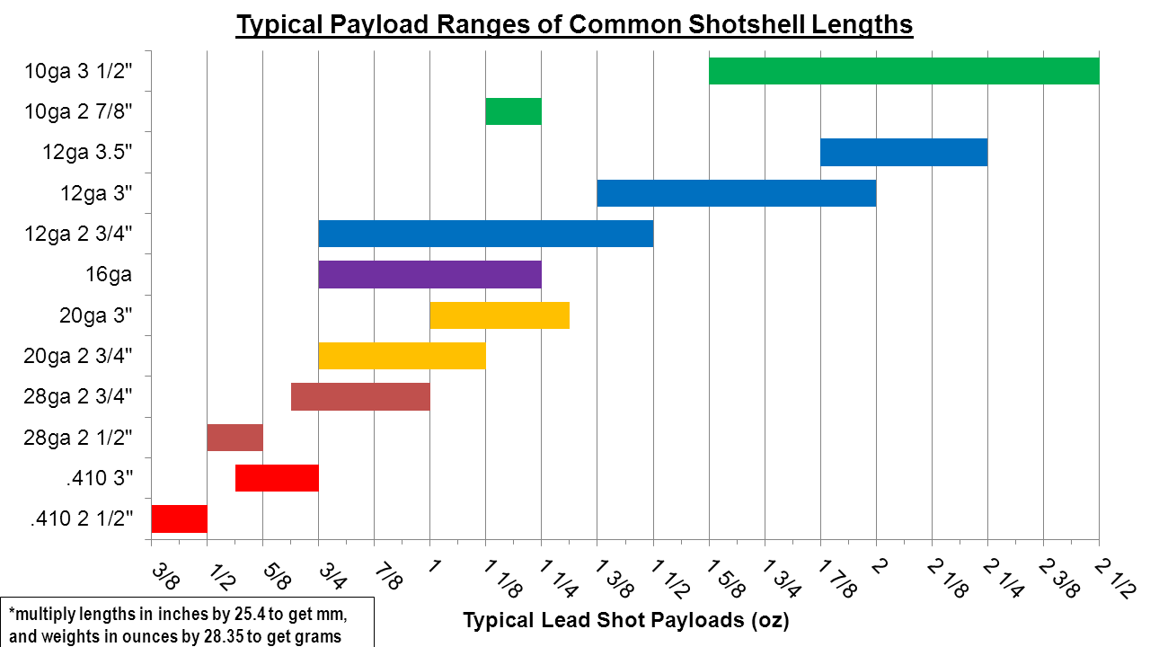

Besides, 16ga 870s - especially the newer ones - are kind of pointless unless it's a gun with some personal significance, or you just like the novelty of the less-common chambering. The 16ga models are the same size and pretty much the same weight (older ones were very slightly lighter, but newer ones are actually heavier since the barrels are 12ga profiles with a 16ga hole inside) as the 12ga guns. Since 12ga shells are easier to find, more versatile, and can handle any 16ga load; you might as well just go with a 12.
