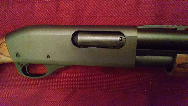

If it's a complete gun, look at the bolt in the ejection port. A SuperMag 870 will have a sliding port cover on the rear of the bolt to keep the longer ejection port closed off when the gun is in battery. Standard 870s don't have this sliding cover, the bolt by itself is enough to close off the ejection port.
Standard 12ga 870:
