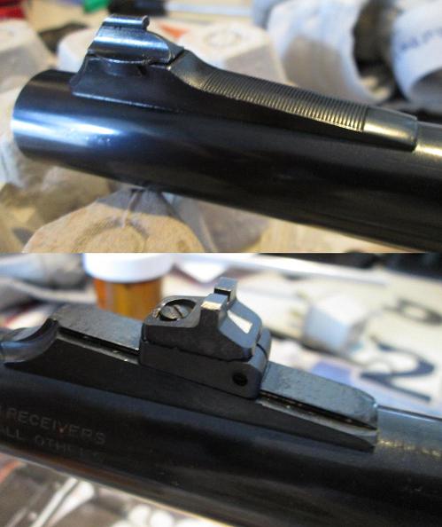

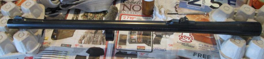

As for sight recommendations, the barrel I use for HD has a simple bead sight on a pedestal, exactly the same thing your gun comes with. It works great for me; I may upgrade to a tritium bead at some point, but part of using a bead sight is establishing a consistent cheek weld & sight picture, so even in the dark, I can pretty well put shots where they need to go.
I also have a Rem-Choke barrel with adjustable rifle sights (both front & rear sights are mounted on the barrel so that I don't have to have anything on the receiver). It works great for slugs, and I plan to use it for some turkey hunting one of these years, too. I've tried it for HD, but found that the bead sight was a lot faster and easier to use, and plenty accurate enough for human-sized targets even at longer ranges.
