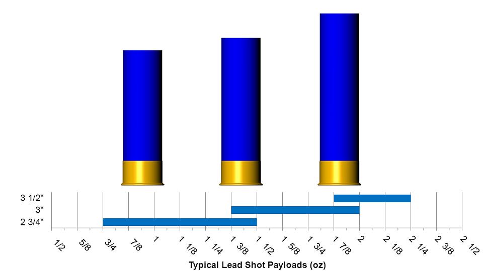

As for recoil, shotguns are definitely known for their recoil, and that reputation is well-deserved. Large-gauge magnum loads can be downright brutal if a shooter isn't prepared, especially with poor technique, or a gun that's too light and/or doesn't fit well. But the thing to remember is that shotshells can be loaded with a very wide variety of payloads, and those payloads can be pushed to all kinds of different velocities. This goes especially for break-action or manually-operated repeating shotguns chambered in 12ga, since there's no autoloading action that needs a certain amount of gas or recoil to work properly, and the 12ga is by far the most versatile bore size out there:
Frame from an upcoming Shotguns 101 video.
12ga shot weight capabilities 960.JPG (33.9 KiB) Viewed 6864 times
Since recoil scales according to the square of ejecta momentum, the 12ga's range of possible recoil levels is extremely wide - possibly the widest in the firearms world. A very light 12ga load with 3/4 of an ounce of shot (a similar payload to a 28ga or 3" .410 shell) can have as little as one tenth the recoil of a full-house, tooth-rattling 3 1/2" 12ga super magnum throwing 2 1/4 ounces of shot. So it's really up to you how hard you want to hit yourself. I would suggest starting with some low-to-moderate target loads to see how your shotgun behaves and figure your technique out, then work up and find where your limits are. Keep in mind that recoil is inversely proportional to the gun's weight (increasing the gun's mass by 10% decreases free recoil energy by 10%); and that the effects of recoil are cumulative, so a 3" hunting magnum can be perfectly tolerable on a turkey hunt where you fire just a few over the day, while you'll want much lighter loads to take out and shoot 4 rounds of 25 clay targets on a trap range.
It should go without saying that an important element in how you feel a given amount of recoil is the point where the gun meets your body. A stock can make or break things when it comes to shooting comfort, and thus, I would recommend against a folding stock, at least to start with. Folding stocks give up a significant amount of comfort for compactness, and unless you really have to make your 870 fit in as small a space as possible, it's generally not worth the trade-off. Get an 870 with a traditional semi-grip stock, install a good recoil pad if the gun you buy comes with a poor one (quality pre-fit recoil pads are available as drop-on upgrades for both Police and Express stocks), and get some experience with that before you go spending money on tacti-cool aftermarket stocks.
You also mentioned 3 1/2"-chambered 870s. That's certainly an option if you want the most versatile gun possible, but if you look at the graph I attached above, you can see that just a 3" chamber still gives you a very wide range of payloads to pick from. 3 1/2" shells can offer some advantages for a few hunting applications (large-game buckshot hunting, extreme-range turkey, and waterfowling with steel shot), but it's really overkill for most things, and a skilled hunter with a 3" shell will do better than a novice with magnum-itis any day of the week. If you're getting this gun primarily for combat/defensive or recreational use, I would say stick to a normal 870 Magnum. Super Magnum 870s are a little more complicated in order to cycle 3 1/2" shells with a standard-length action (the 870 was developed nearly 40 years before the 3 1/2" super magnum was introduced), they can be harder to find parts for, and there's no such thing as a Super Magnum Police or Express Tactical; the only 870 Super Magnums are hunting Expresses that at the very least would need their barrels custom-shortened to be configured as a riot gun (you can swap a short Police or Express Tactical barrel onto a Super Magnum receiver, but then you'll be back to a 3" chamber, so it defeats the purpose).
