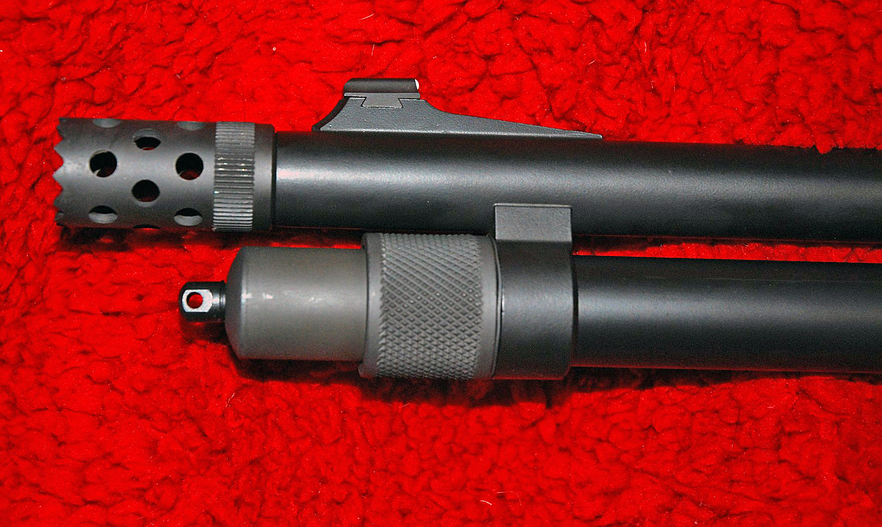

I used a Wilson Combat +1 on mine, with the WC spring, and an S&J Hardware follower.

Re: Photos of Extension for 870 magpul?
- DSC_5598.jpg (460.48 KiB) Viewed 5422 times
