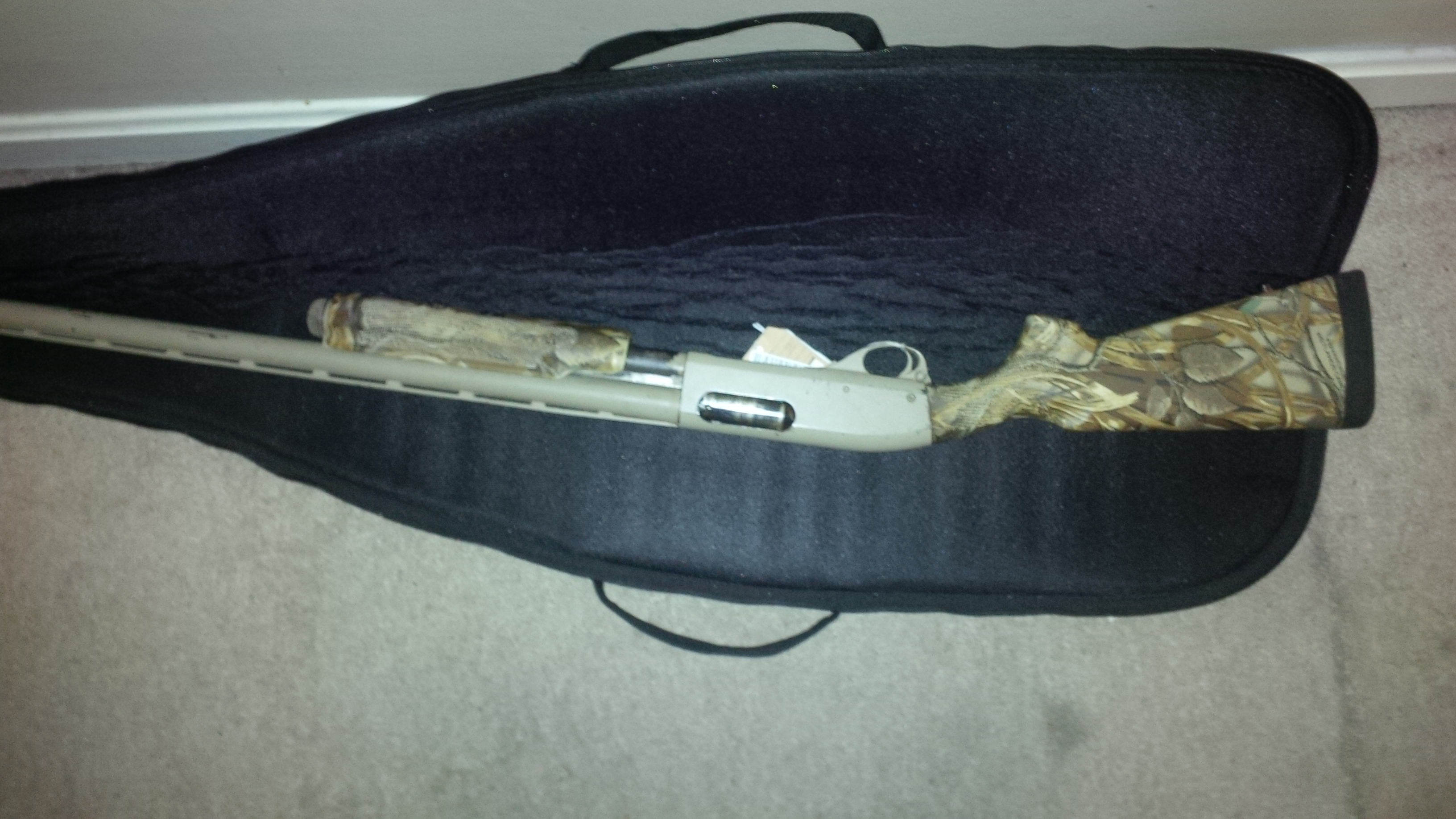

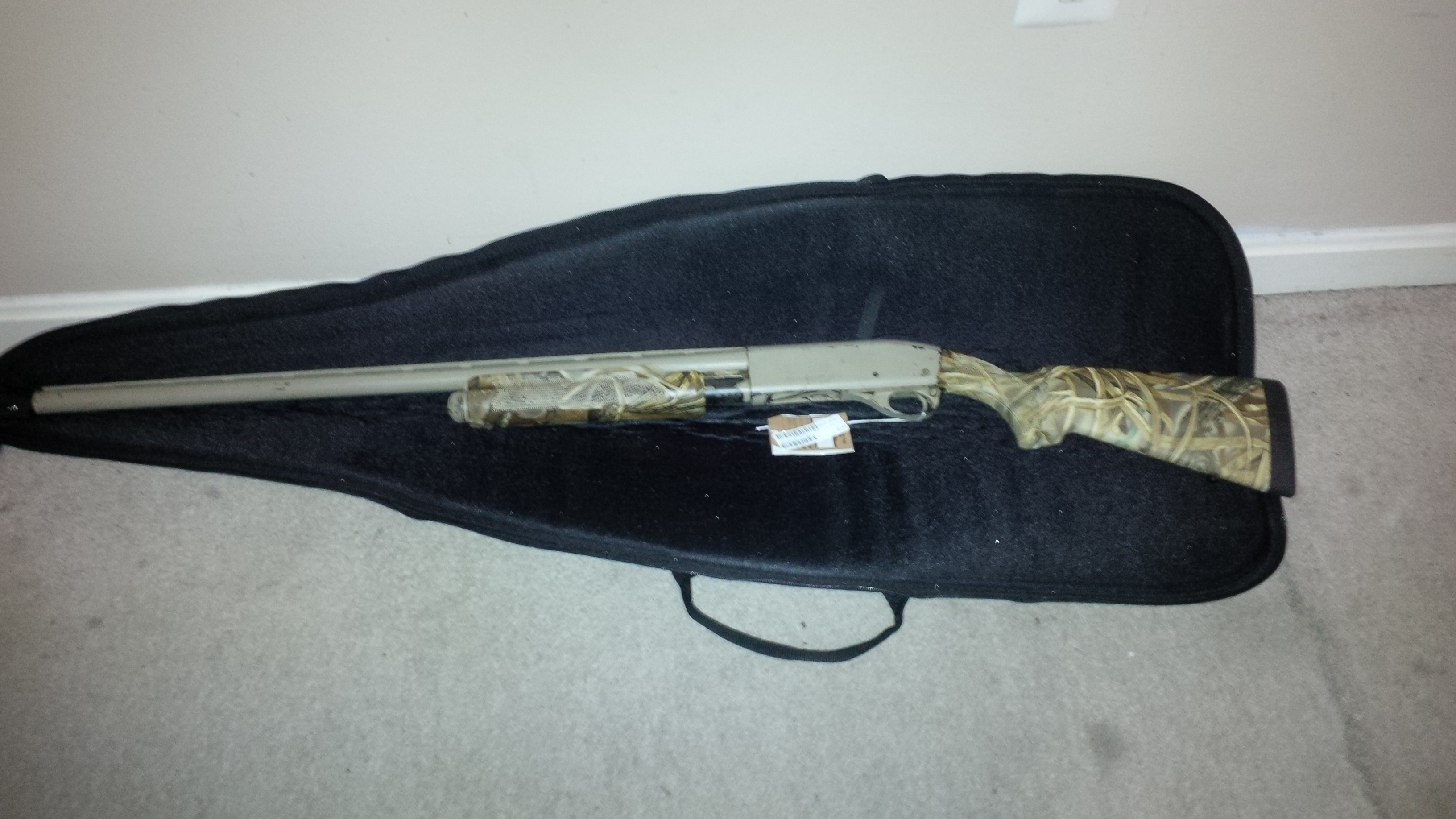

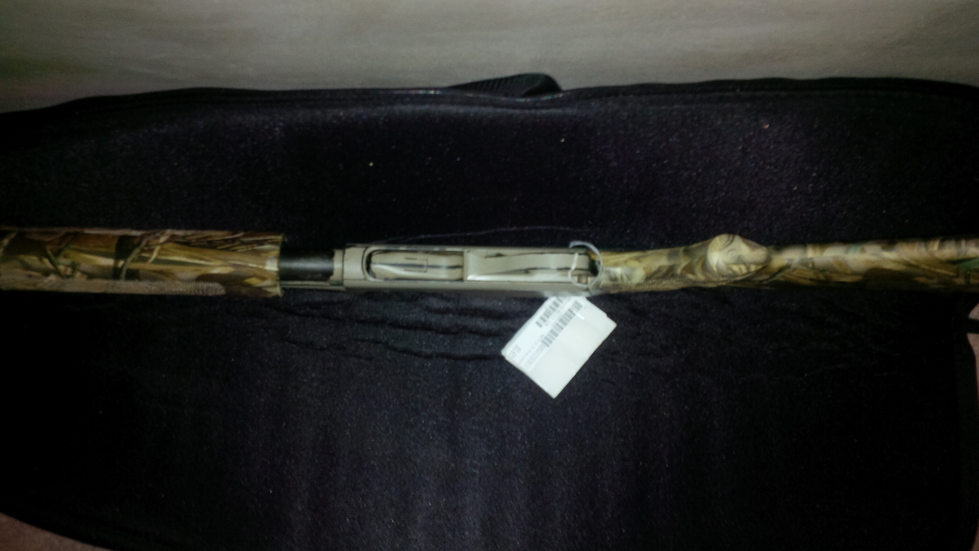

Thanks very much. I am trying to put together a budget for a modest rebuild/ refresh of this gun so this type of very specific feedback is exactly what I'm looking for. Would you say that this spring is a common wear item and if so would you recommend simply replacing that spring now? Easy to add to the list of "while I have it opened up and am in there..." items. BTW Here are some pics of the project gun. Thanks and I've been working through your 870 vids on youtube, very informative.
Just trying to get a straight answer in a sometimes twisted world
Re: Found me a scatter gun
City Rat wrote:Thanks very much. I am trying to put together a budget for a modest rebuild/ refresh of this gun so this type of very specific feedback is exactly what I'm looking for. Would you say that this spring is a common wear item and if so would you recommend simply replacing that spring now? Easy to add to the list of "while I have it opened up and am in there..." items. BTW Here are some pics of the project gun. Thanks and I've been working through your 870 vids on youtube, very informative.
Wow, those are some big pictures. In the future, you should re-size your images before uploading them. Huge images take up more space and stretch the page, making the pictures harder to view and your post harder to read.
Anyway, I wouldn't worry about replacing that spring. If the port cover is sticking in the forward position, then you may want to look at the spring (though it's more likely that the port cover itself is bent or gummed up with something); otherwise, as long as the cover moves freely and slides back to cover the ejection port whenever you close the action, you should be fine. It's not like the port cover serves a critical function where a weak spring might throw something else off. It's just a spring-loaded dust/mud shield for that elongated ejection port.
Although, if you're going to be ordering other replacement parts anyway, and and you're worried about port cover problems, I suppose you could order a replacement port cover & spring just to have them on hand. Probably not necessary, but it'll make repairs a snap if one of those parts does get damaged someday.

Thanks again for the advice and sorry for the pic size, Its my first time posting a pic and I did it from my smartphone while commuting to work, so hard to even know file size was an issue.
