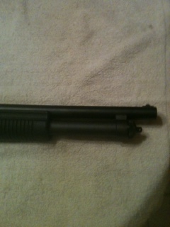

I just bought a Tactical with 18" barrel and 2 shot extension.
If I want to go skeet/trap shooting, can I simply buy a longer barrel, say 28"?
Reason I ask is cause I have seen other 870s with 2 shot extension that are screw on but mine isn't.
Mine is a solid tube.
Does that make any since???
Thanks for any imput!

Are you sure it's a solid tube? Reason I ask is because I had a HD Tactical version from the factory that had an extension on it...of course, if I wanted to remove it I would need a standard cap, but it was still removable. I thought all factory 870s had the standard length tube, as creating a new, solid extended tube would require a different manufacturing step since it's attached to the receiver.
Also, all 870 barrels are built with (to my knowledge) a ring that fits over the magazine tube at the point where the standard tube ends, to allow the magazine cap to secure the barrel in place. Tube extensions accomplish this as well by screwing into the standard tube and locking the barrel in place- with a solid tube, I'm not sure how this would be accomplished.
Can you post pictures?

Please see picture.
I also measured the distance from the end of the receiver to the ring of the 18" barrel and it's 15.25".

I just found a better pic on this site:
General Discussion/Rem 870 Express Tactical whit BlackHawk stock. (81404)
my stock is different, but the barrel and shot extension are the same.

Well there's a horse of a different color. I looked that configuration up on Remington's site, and it appears that is THE ONLY model that comes with the longer one-piece magazine tube and different barrel. All of the others on their site are standard receiver/mag tube configurations with standard barrel ring locations, and mag EXTENSION tubes to add extra capacity...see all of their other tactical photos below:

I know those don't help you solve your problem of wanting to put a standard 28" barrel on to shoot skeet with, but since I've never seen your configuration before I don't really know if it's possible. It appears that your shotgun was specifically designed for LEO/Military/Home Defense where the extra capacity is needed without the reliability issues that can sometimes be associated with the extension tubes.
You may want to call Remington Customer Service to see if they have an option. Or, buy another 870 for shooting skeet!

Just called Remington and the tactical version with 6 shot magazine tube can ONLY have tactical barrel.
Wanted to let ya'll know.
