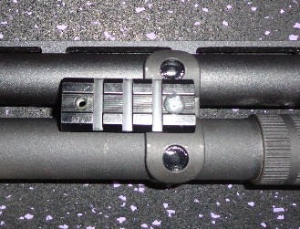

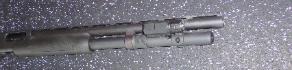

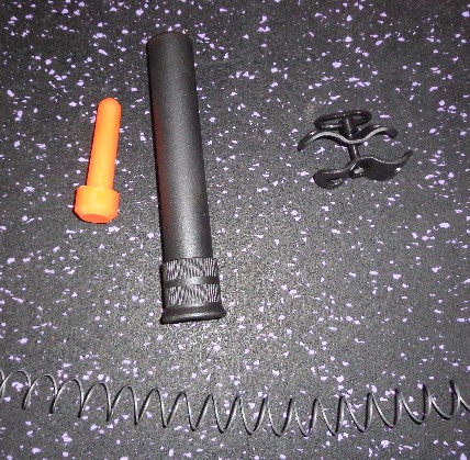

My new Choate +2 Extension arrived today and I was pleasantly surprised with the quality. I have read some horror stories for reviews on finish, fit and functionality. I don't have any of those problems. Fit is perfect, the parkerized finish is great (a VERY close match to mine), and it functions great. I have cycled maybe 60 shells through it with NO hangups whatsoever. Yet to test fire but dont foresee any problems. The supplied follower is a little rough so I stuck with the original one but no big deal as I plan on replacing it with a stainless or aluminum follower with my next order.
I also modified the supplied clamp to accept a small weaver rail for a light. I had a small 190 lumen tac light in my safe so I slapped it on for now until I get the one I really want. Total cost to modify the clamp is maybe $8. Word to the wise. Use something inside of the clamp to protect your finish from marring. I used the soft side of self adhesive velcro. Works well. And the finished product. If anyone has ANY questions please ask. Thanks.
