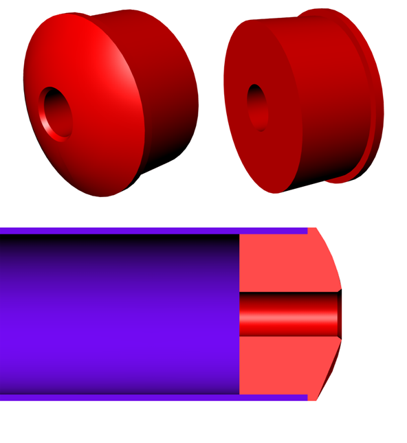

The Wilson Combat/Scattergun extensions are good kits, reliable and an excellent value for the money. But because they're a budget kit, they're made to a price point, so you get things like a non-relieved end cap that saves the company machining steps:
Wilson Combat end cap.png (86.93 KiB) Viewed 19470 times
Also, the Wilson Combat +2 is sized to fit under a true 18" barrel, not the 18.5" barrels that are more common on current fighting 870s.
The spring in the Wilson Combat +2 kit is a beehive spring, wider in the middle and narrower on the ends. This and a relatively slim wire diameter makes it pretty space-efficient. It's plenty stiff for good function, especially if you're not machine-gunning your 870 with heavy loads, so you can trim a little off. Just don't get too carried away, especially if the spring is relatively new, and hasn't taken it's initial set yet.
