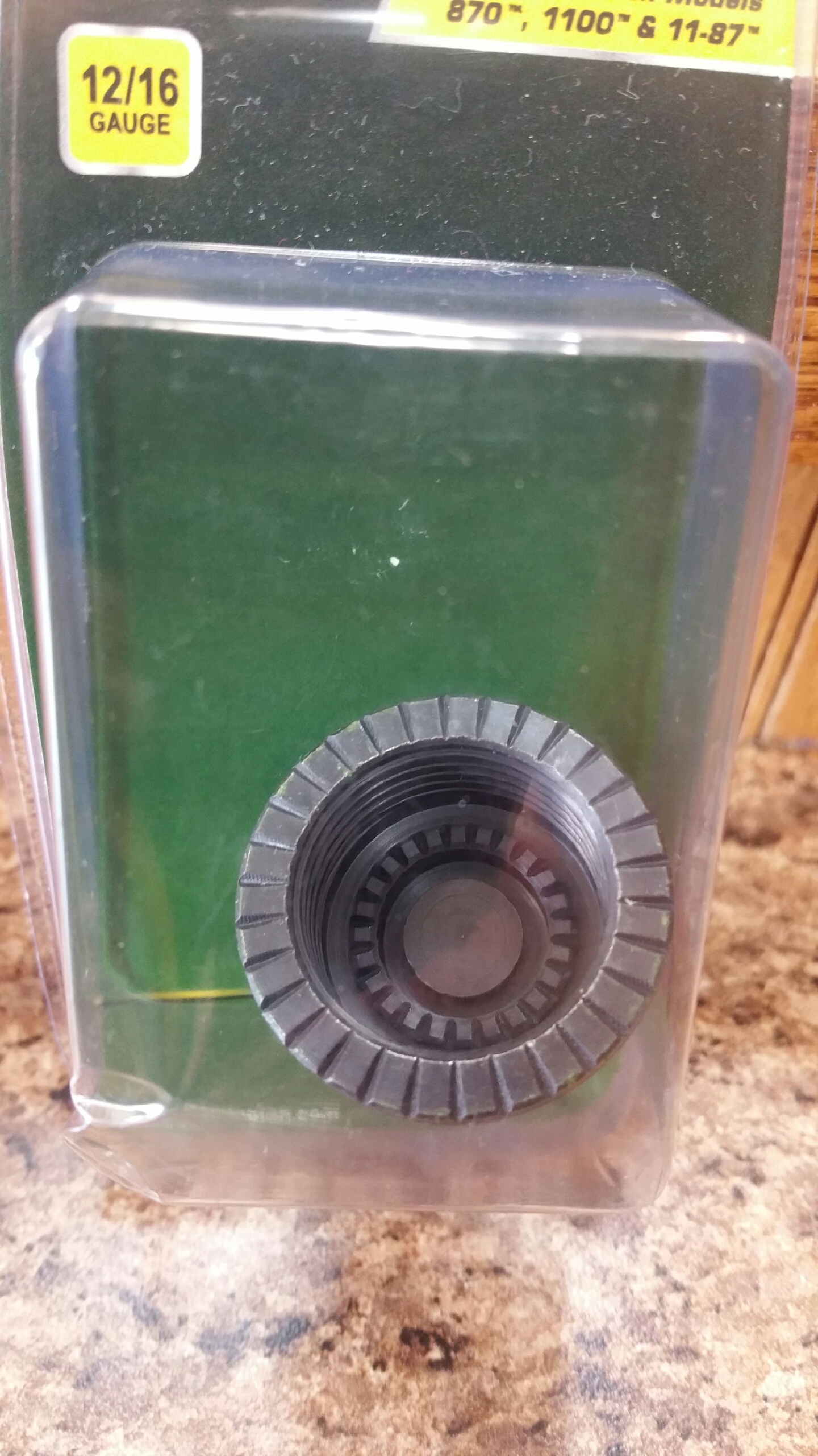

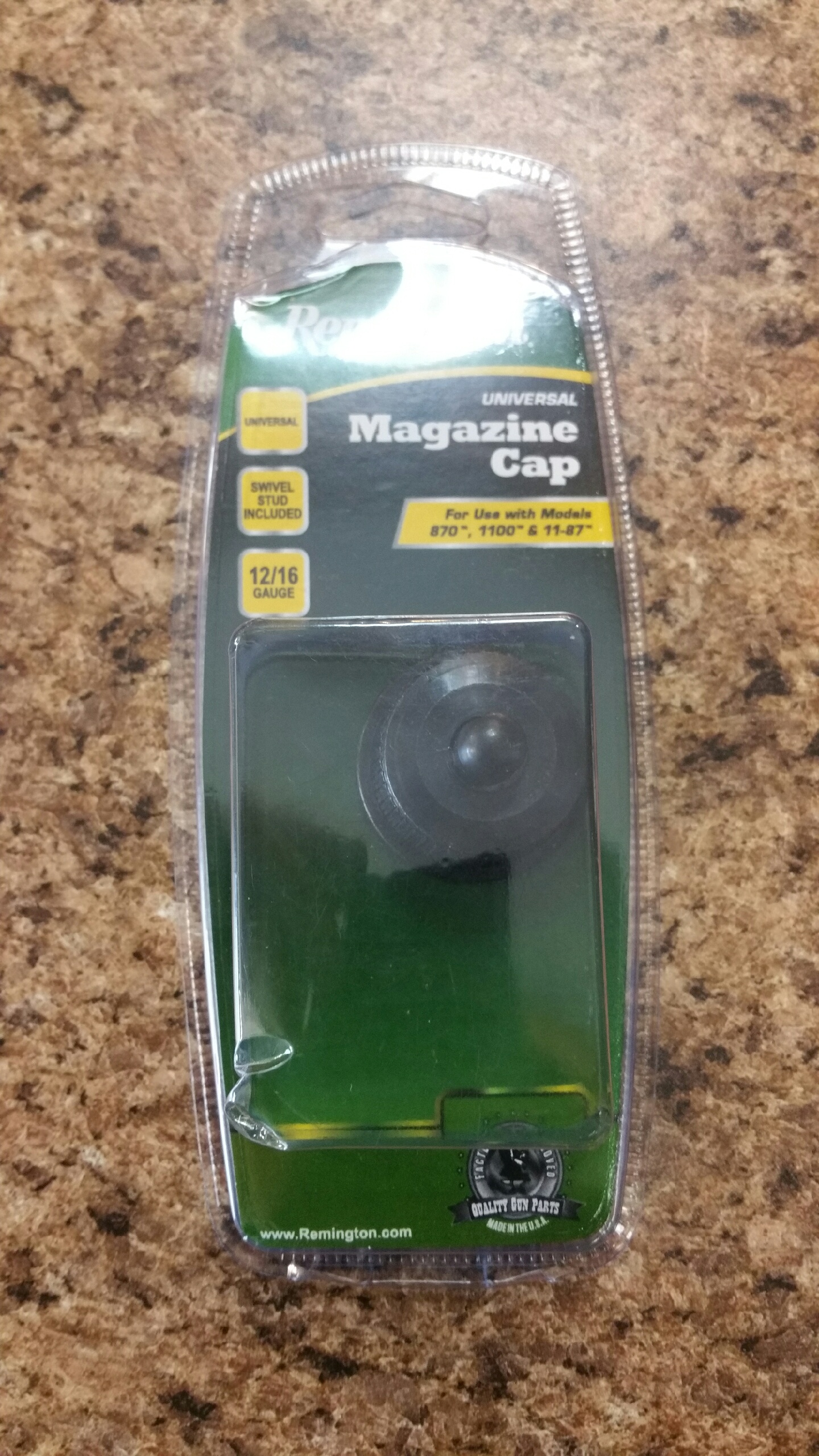

Need some help here. My 870 Youth did not come with a front sling swivel stud. No problem right, new magazine cap with the right stud and ….. wait! The 20-ga youth does not have the ball & detent ratcheting system like the 12-ga Express. Here's what I received (left) in an Uncle Mikes 1800-5 package that claims to be for the 20-ga, and on the right was the original (sans any stud).
There problem is internal: my replacement seems to be for the ball & detent system (left) while my original (right) has an internal ratchet system.
My replacement "looks like" the 1800-5 shown (https://www.unclemikes.com/products/acc ... 70-express) whereas the 870 20-ga 1801-5 "Youth version" from Uncle Mike's (https://www.unclemikes.com/products/acc ... -870-youth) has a different profile.
Any thoughts? My LGS isn't well-stocked enough to grab a package and find the right one.

Doesn’t help you but i guess just have to find a Remington later made 20 ga cap.
Part # 19461
Part # F401448

Yea, trouble is some of them say "detented", but don't show which method is used. There can be a ball detent, or the ratchet-type detent that is on the magazine spring retainer. Sheesh......

Here may be your fix. Remington has a Universal cap that is serrated on the inside of the cap for the newer barrels and serrated on the outside for the older barrels and comes with a stud for the stock. The 20ga part number is 19461.
Posts: 1315
Re: Rem 870 Youth Replacement Mag cap w/Sling Swivel Stud
Germansheperd wrote: Thu Jan 03, 2019 6:59 pmThe 20ga part number is 19461.
Thanks. The pics on Remington's website sure don't help them sell anything, because those back-side images weren't available to help my buying decision. But thanks for the info.
