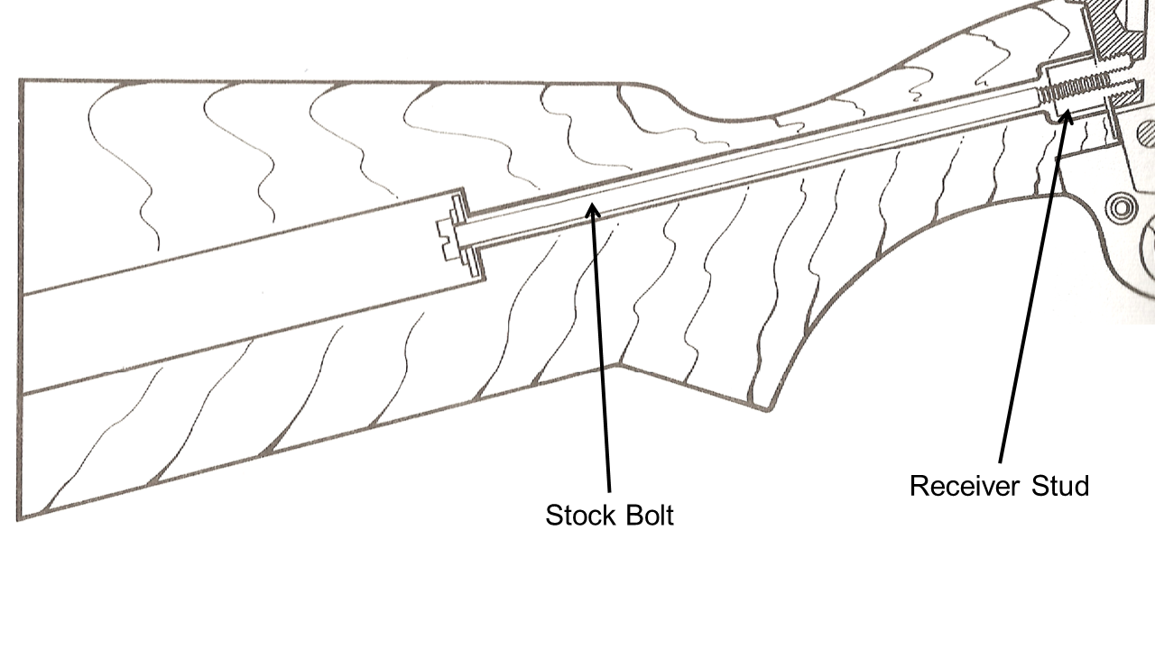

I have a 870 youth 20 gauge and I need to cut down the stock. Current length of pull with recoil pad is about 13". My sons LOP is 10" How far down can I cut down on the wood stock?

Factory & aftermarket stocks are typically available in 14", 13", and 12" lengths of pull.
If you want to know how far you can cut a wood stock down, take off the recoil pad or buttplate, and measure the distance from the bolt of the stock to the head of the stock bolt inside. That's how far you can go without getting into deepening the stock bolt recess & coming up with custom or replacement fasteners. If you're cutting the stock extremely short, you'll also probably need to have a custom recoil pad fitted, but that isn't that big of a deal.
- Slide06.PNG (286.69 KiB) Viewed 5753 times
