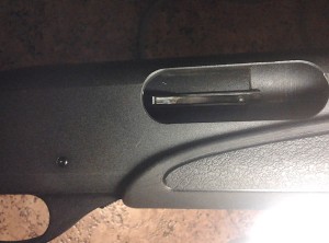

Will Remington 870 Work Without the Ejector Spring?
I was curious about that but never had a chance to test that. But recently the ejector spring broke on my Remington 870 and that was a good opportunity to test the shotgun without the ejector spring.
It will work! The shotgun was working properly but with much bigger chance of the stove pipe problem. I had a stove pipe for about each 5-10 shots. So yes, you can still use your shotgun with broken ejector spring in an emergency situation but you need to replace the ejector spring as soon as possible.
Broken Ejector on Remington 870 Express Shotgun

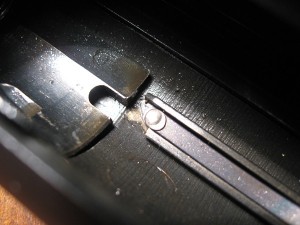

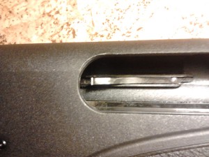

The Most Frequent Problem with Remington 870 – Broken Ejector or Ejector Spring
I receive lots of e-mails from Remington 870 owners. Many of them ask questions about upgrades or need advice about repair.
So, what is the common problem of new Remingto 870 Express shotguns? It is broken ejector spring or ejector itself. And the worst thing is that sometimes it is pretty difficult to repair it.
Here are several photos to illustrate the most frequent problems with ejector and ejector spring.
Broken Remington 870 Express Ejector:
